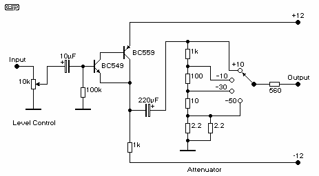

I made this small toy organ, like those ones you make with a couple of transistors and 12 resistors, and is it possible to take the output on it (square wave) and convert it to sine wave to have more of an organ sound?
Can it be done or would i need to build some separate oscillators and tune them?
I did some searching and i think its something like this (see pic)
The schematic is from **broken link removed** under Level Control and Attenuator
I also found this as an oscillator: **broken link removed**

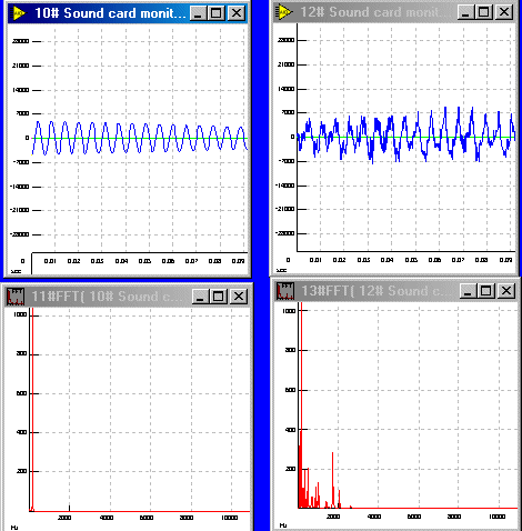

If you want to make a squarewave more like a sine wave, you would have to use low pass filters. With that said I have to tell you, a sine wave would sound no way near like an organ, as an organ is rich in harmonic contents.
Compare the image below.
The image is a time and frequency domain showing the output of my keyboard. the one on left is a sine output, notice very pure in spectral content. The right is an organ output, much more harmonic content.
To produce an organ sound, you will have to find the right filter cutoff frequency of your filter. A pure sine would sound more like a plain tone.

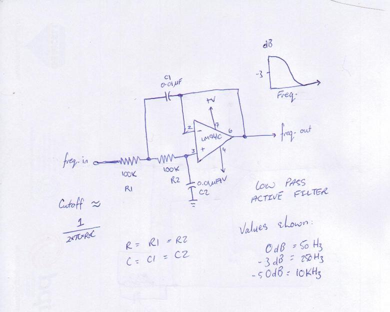

I have a schematic for a low pass active filter using a LM741C. Is this the filter? This is from an engineers notebook, but can you explain to me what the formula 1/(2*pi*R*C) means? I get 0.000159155 when R is in ohms.
Oh, ok thanks. I haven't used this type of formula before. Am I still able to use the low pass filter to make the sine wave more like the square wave?
With a LPF you can convert your square wave to something more like a sine wave, but I suspect you will not get the sound you want. To produce an organ sound requires a very complex filter with ripple at known points along the passband. This requires a good deal of knowledge in filter design.
