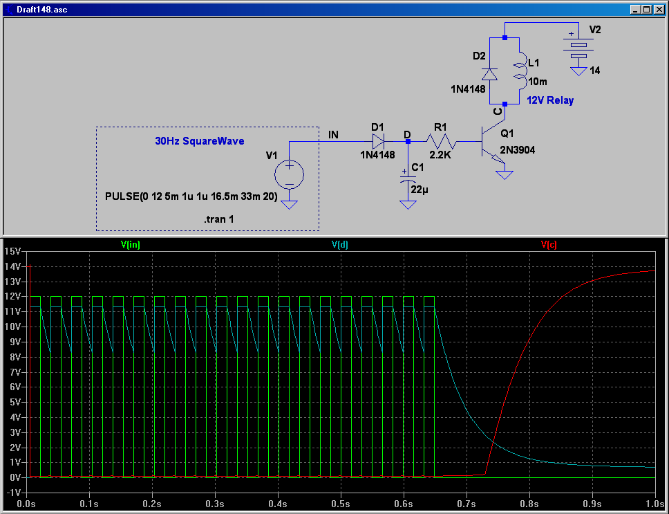

Here is something much simpler.
ps, after posting it, I thought of a potential problem. What happens when the key is first turned on before the engine is running? Is the tach signal High or Low? If High, then it needs to be slightly more complicated.
The tacho needle doesn't move while the engine is cranking,only when it's actually fired up does it go high.
Chris.

Not by the time you make an automotive glitch tolerant power supply for the microcontroller, add a switching transistor (because the microcontroller can't drive a relay, etc, etc). Microcontrollers are neat, but don't solve every problem...
i have to say thats a nice elegant solution mike! far less likely to go wrong or glitch than a mcu. i realy like the simplicity of that!
You can capacitively couple Mike's circuit, like the old VOX relays that turned on when audio was present. Given the reliable 12v input waveform it should be very easy and it's a good way to do it.

A glitch proof regulator is a good idea irregardless of what way you do this. The first 60 volt load dump will blow the brains out of that little 3904. Likewise for a polarity reversal.

So I take it this circuit isn't looking for a 30 Hs s/w as such,just any 12 volt s/w?

Maybe a bit more complicated than I need,would work well as some srt of warning thing though.
