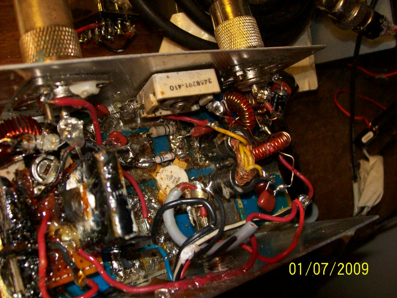

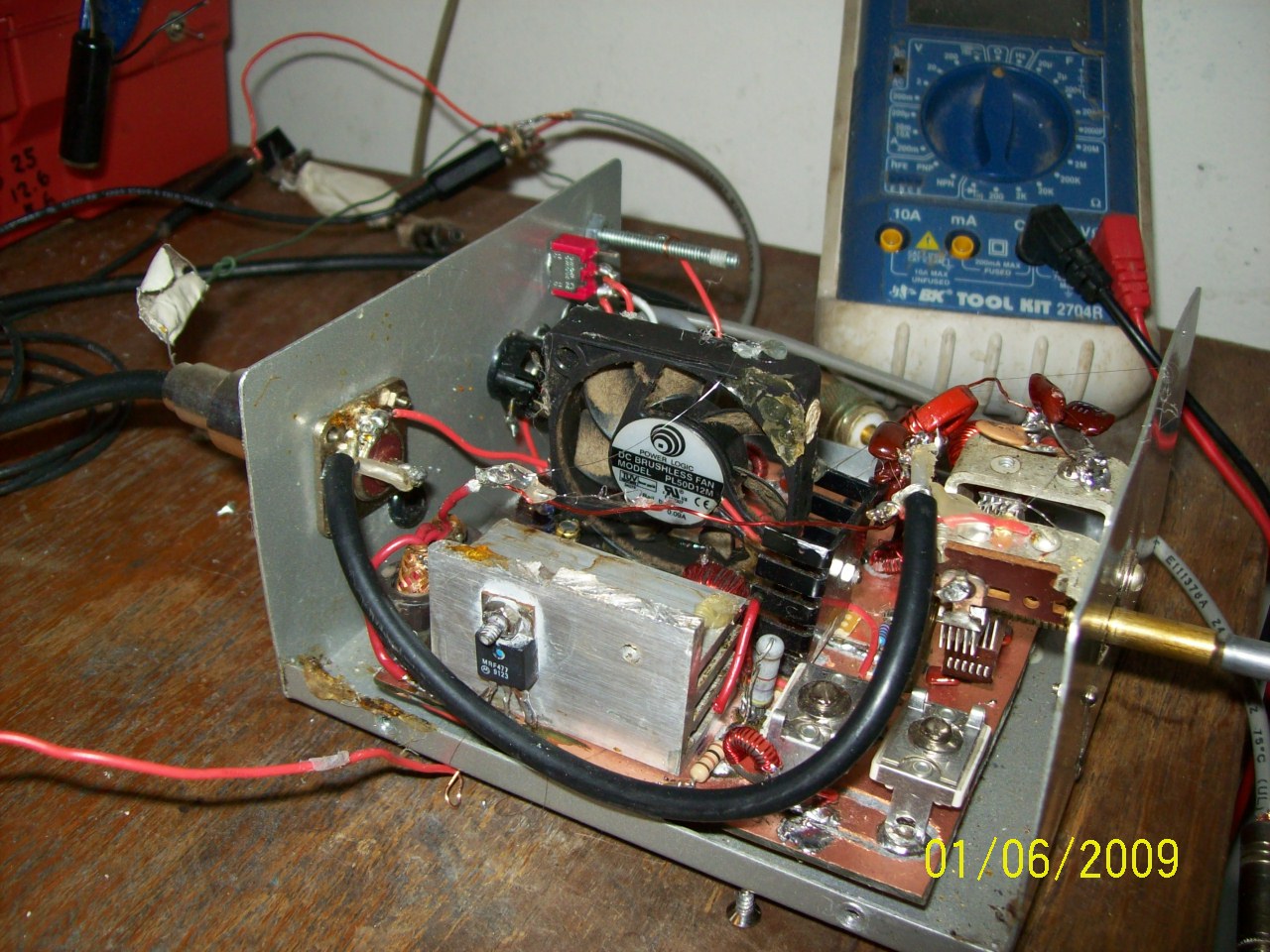

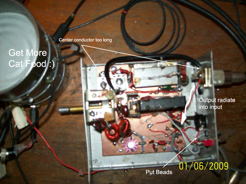

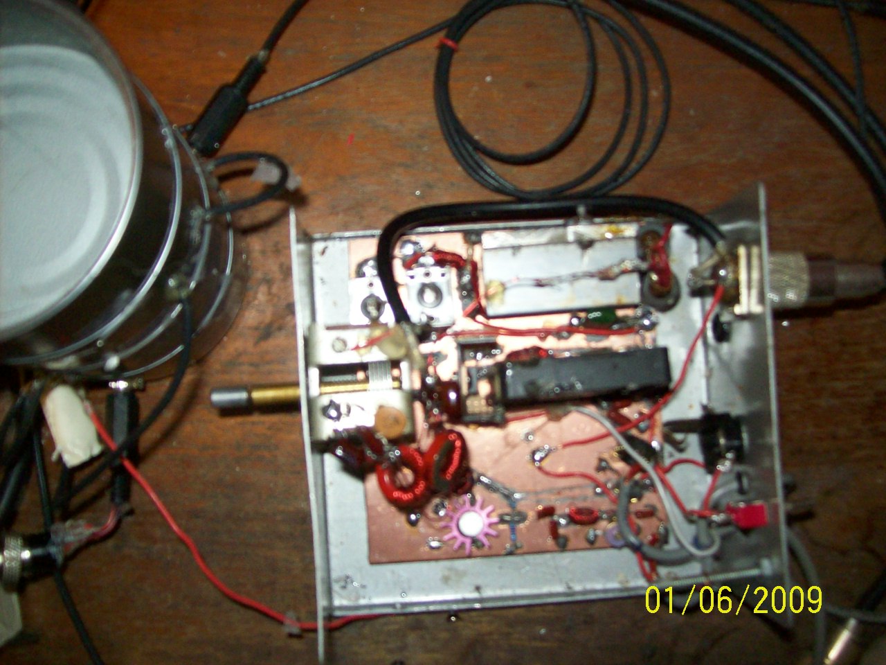

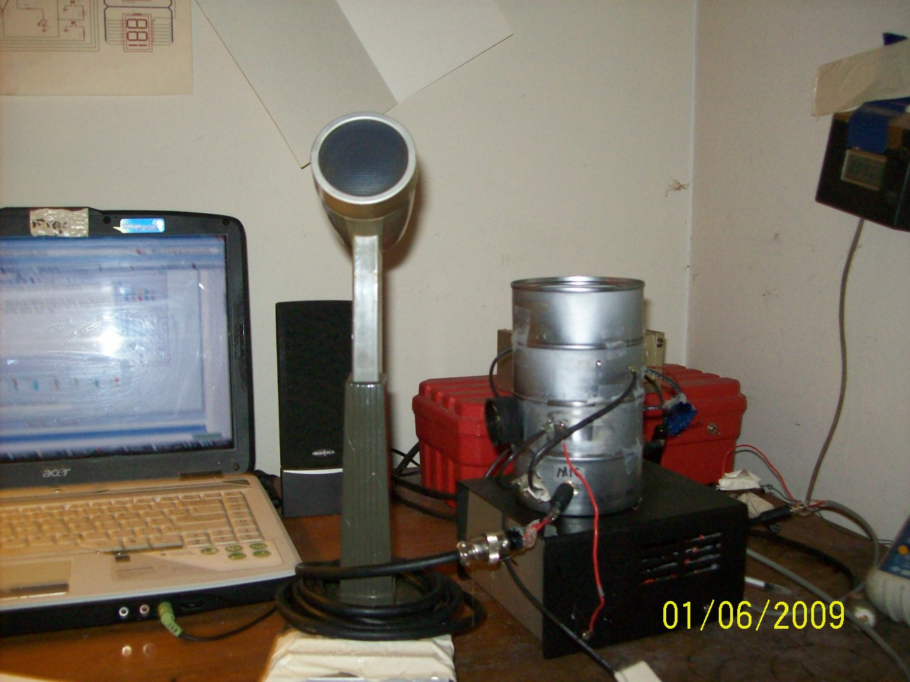

Here are some pics. I show the modulator sitting on top of the amp in my usual cat food can style.
1. Modulator
2. Vertical view of Amp
3. Shows MRF477 mounting
The amp is putting out about 10 watts but peaks to about 7 watts clear audio (un-clipped). Normal speaking into mic. I really don't like the mounting and prefer SOE type mounting. But I think this is about the best you can do with a single ended stage using this transistor.

I made a few comments. See your image.

How are you dissipating 80watts, Is there a heatsink underneath?
But of course. And a fan with filter circuit. Believe me, when I 1st put it together I would have used at least a good 6 x4 inches of Avvid black annadized aluminum with 3 inch fins sticking out running length wise down the back. But I didn't have any on hand.
Well 80 watts is a little much power to put on a VFO and single sideband being so frequency tight with even having to keep the BFO offset pitch exact, I've elected to put in PLL. Here's my circuit. I'm using a Motorola MC145170 and a PIC16F690 micro.

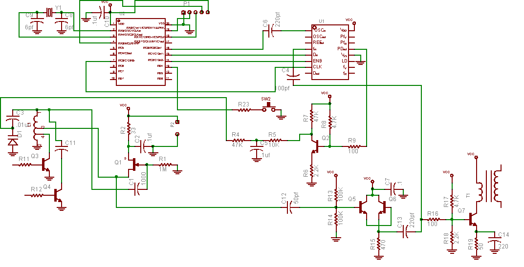

I'm using the processor's internal timer interrupt tied to an I/O port to generate my reference frequency. This gives me flexibility to change either the fin input divider ratio or the reference by jam loading the timer with new count values.
Here is some code. Currently I have the timer interrupt set at 20KHz so I toggle the output port for 10KHz (reference). The first 3 values in look-up table at address 200h are the fin divide from 11MHz. I'm starting with 11.150MHz. So if I divide by 45B hex, I will arrive at 10KHz.
