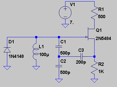

Let me see if I can clarify for you. Look at attached image. Circuit is a 1MHz colpits osc. Notice the tuned tank consist of 100uh inductor and split caps at 500pf each which means cap value is 250pf.
Now if you plug these numbers into the formula Fo= 1/(2pi√LC)
You get a value of 1MHz. This result should give an indication that above formula works.
So you should start with two known values, say Frequency and capacitance.
Transpose above formula to solve for L. L= 1/(4pi²CF²)
If you don't want to work out the math, try this online resonance calculator.
This should get you close to the ballpark figure for the inductor. Most LC oscillators I have seen use a variable inductor. The kind that you adjust the core with little plastic screwdriver.
There is really a lot of ugly math involved, but above method should get you in the ballpark.
Hope that helps.

ok, thanks. Everybody is saying that I should not think about a desired reactance to shoot for but just match the tuning cap that I can find somewhere. That will be the practical thing to do.
Since I will have to order any tuning caps I need I'll think about tuning range required and go from there.
At resonance reactance is ideally infinite or zero so I'm barking up the wrong tree anyway :) arf arf
