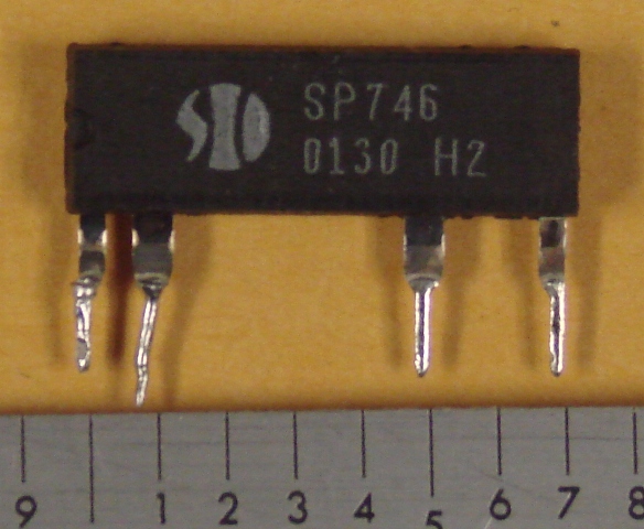

Does anyone recognize the manufacturer's logo on what I think is a SIP SSR?
The back is labled:
93047
PHILS
Ken
This is from the manufacturer " Solid State Optronics "
Its a bi-directional, single-pole, single-throw, normally open multipurpose relay.
The circuit is composed of one LED on the input side which activates an optically coupled IC on the output - controlling the firing angle of two back-to-back SCRs. This circuit assures no false triggering under most adverse conditions, and a tight zero-volt window not exceeding 5V.

Many thank DevilMKD!
