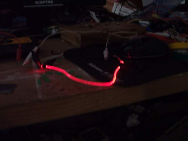

Neelyjer I tried glass fiber and a red led it didn't work. But clear tube and with a red led both ends worked so I would say it works like I said 2 red leds and 2 blue and 1 high bite green take a look if you put three together it would look just like what they did and the pwm

Neelyjer I made a little video you can see how it would work with the clear tude and pwm
with all 3 colors it would be cool. [embed]http://www.youtube.com/v/uBH0uhQt6t4&hl=en&fs=1[/embed]
And there using a lot bigger tube
Neelyjer I added green and blue leds [embed]http://www.youtube.com/v/BT6DrGk3RcM&hl=en&fs=1[/embed]
That effect is almost exactly what I'm hoping for, only with multiple LEDs and with different colored LEDs illuminated at the same time. What did you do to get that result?
