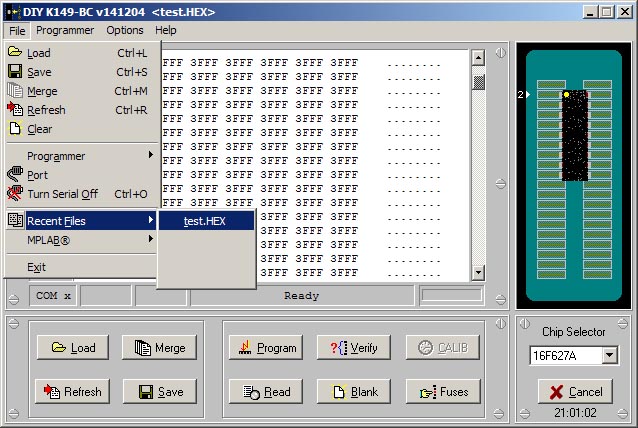

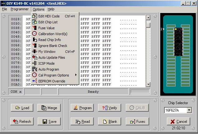

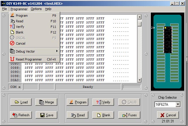

Anyway. I found this programmer from ebay which I liked very much. It is fully USB meaning that power and data goes through USB. No PSU.
It cost me less than the other one. It arrived 2 days ago. I checked it and it was working, and the package includes everything you need. I think it is very good. What do the experts say?

I am including 3 screenshots to see the menus and the features.
