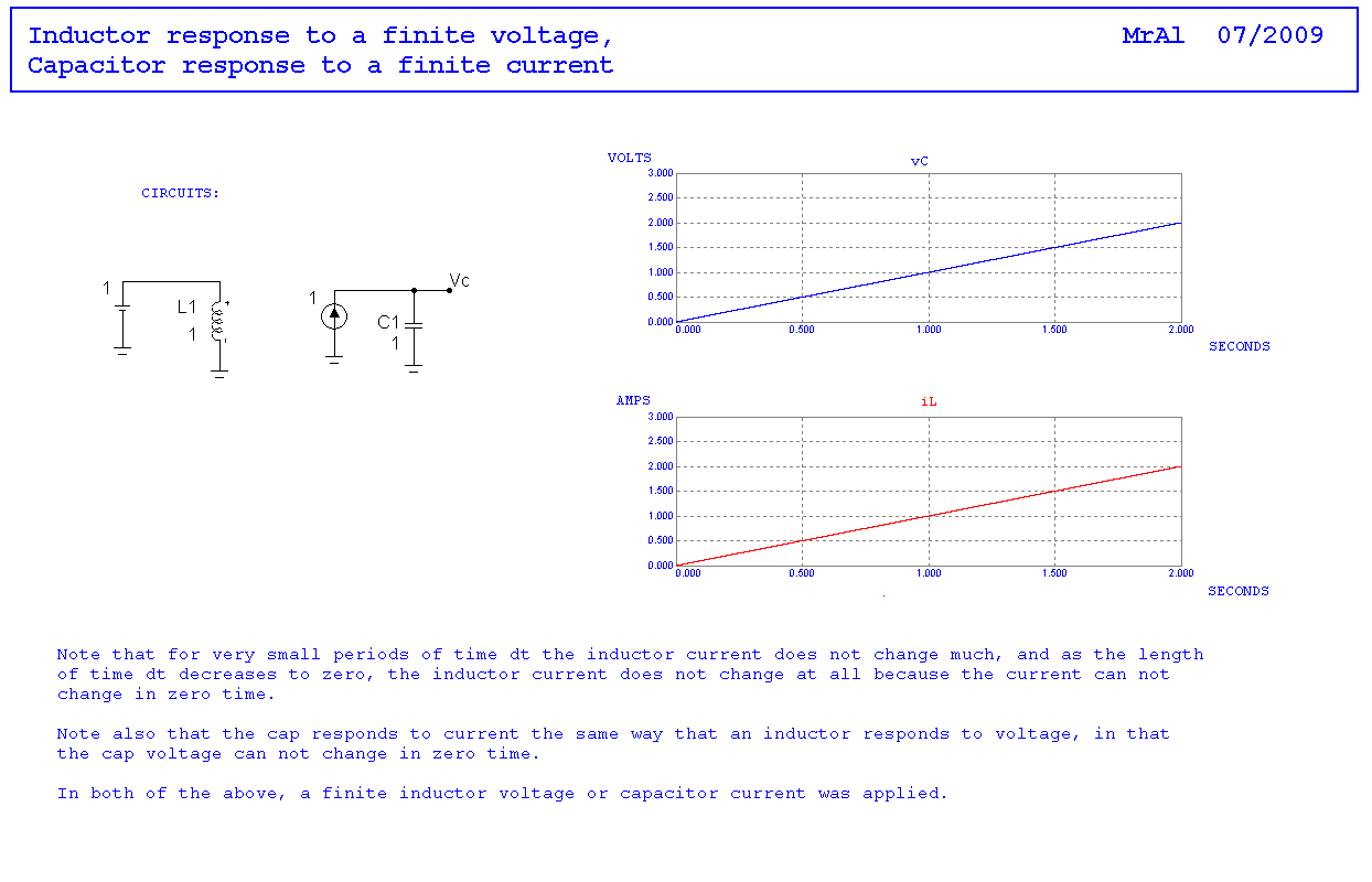

We can show how the inductor reacts to a jump in voltage by looking at
what happens when a voltage is suddenly switched across an inductor.
The inductor current does not jump up to any value because the inductance
depends not only on that voltage but also on time. In other words, the L
needs time to react to the v before any current can actually flow. This
doesnt mean that it doesnt start to flow, but starting to flow and actually
flowing are two different things.
If we simply look at the defining equation for the inductor:
v=L*di/dt
we only wish to find out what happens to di for very short periods of time dt,
with constant voltage (across the inductor) of v.
Solving for di:
di=v*dt/L
Now lets first look at what happens between two time periods very close
together. We will look at t0 and sometime later t1:
di=1/L*(v*(t1)-v*(t0))
and when we let t1 come very very close to t0, we end up with the same
equation:
di=v*dt/L
and now take the limit:
di=lim [dt->0] v*dt/L=0
In other words, when dt approaches zero so does the change in the current.
Stated another way, the current does not change in zero time (dt=0) for any finite
applied voltage v.
This means that iL(0+)=iL(0-) because the time between 0- and 0+ is considered
to be zero.
If you would like to see this done with another method, post that method next.
Here is a drawing of the inductor I response to a step change in voltage, and a
capacitor voltage response to a step change in current:
It becomes apparent that the first derivative is not zero, but that
the initial value of the function is because there is no time to allow
that change.

ok
1.i understand that for an inductor I(0-)=I(0+)
and for a capacitor V(0-)=v(0+)
but you said that it depends on the source type
does it depends if an inductor is connected in parallel or not for current continuity?(current source) ??
does it depends if a capacitor is connected in parallel or not for voltage continuity?(voltage source)
2.does a circuit without a switch is continues for starting condition?
3.when on a circuit with a switch i can see that there will not be a continuity on starting conditions?
4.what happens on impulse regarding the starting conditions?
5.how to find the I'(0-) and I'(0+)
on my original circuit

[5]
Yes.
In your circuit the cap current comes from the inductor
initial current, and the inductor voltage comes from the capacitor
initial voltage. In those two ciruits i posted the same thing is
happening, the only difference is that i used two separate circuits
instead of one (of course the results later in time may be different
for the two circuits than for your one circuit).
I really think you should work out the solutions for those two circuits i
posted, because they involve the same principles only they are a little
easier to understand. Then later you can apply those principles to your
circuit with the three switches.
