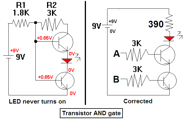

I built a simple circuit as an experiment. I thought it should have worked, but unfortunately, nothing happens. The goal here was to simply light the LED:
My logic here is this: the two resistors that you see act as a voltage drop. The bases of the transistors, after all, don't require 9V. At the same time, these resistors should lower the amount of current that flows through the LED so that I don't burn it. Since the bases of the transistors are always connected to the power supply, they should allow current to flow through them and light the LED.
However, nothing happens. The LED does not light.
Frankly, I'm not very experienced with a multimeter, so I don't know what to test and where.
Can anyone explain why nothing is happening?
I'm not sure what you trying to do with the transistors. If lighting the LED is your only goal, you only need one resistor and no transistors. A led will have a voltage drop (think, the amount of votage that it "consumes") and you need the resistor to take care of the rest of the voltage. Typical voltage drop for an led can be from 1.7 to 3+V. LEDs typically will run on 20 mA current so we select a resistor to limit the current to that. I'd just pick 2V. then use ohms law V = IR. Rerarrange so that R = V/I = (9-2)/.02 = 7/.02 = 350 ohms. a 390 or 470 ohm resistor would work fine (these are standard values). If the LED fails to light, you've probably got it in backwards.
If you are trying to get the transistors to work, I'd start simpler.
Well, being a newbie, I'm kind of experimenting with transistors. I also hoped to implement a sort of a logic AND gate here.
In the schematic, the two horizontal wires that lead to the bases of the transistors could have switches. I hoped that the LED would light only if both switches were closed. But the LED doesn't light at all, regardless of whether the hypothetical switches are open or closed. I really have no clue why. Perhaps lowering the resistance should work?

I re-drew your circuit so that the transistors are "the correct way up".
For the LED to light, one transistor must conduct to 0V which happens, but the other transistor needs to be at a higher voltage but cannot with its base connected to the base of the 1st transistor.
My circuit has both transistors completely separate. If one input goes high but the other input is low then the LED does not light. If both inputs are low then the LED does not light. If both inputs are high then both transistors turn on and the LED lights.

Same here, although he'll get more current if he moves the 820 to be in series with the LED.
Can I ask, how did you come to those base resistor values of 470R? If we assume a transistor HFE of about 150ish, and 8.3V dropped across the base resistors (leaving 0.7V for the base-emitter junction) I make it 62K for a 20mA LED. Of course none of this is critical because the exact HFE value will never be certain, but 470R does seem quite a low value resistor.
Other than that, it makes better sense to have seperate base resistors because you should bias the transistors seperately. If you use just one base resistor, then the voltage drop across the base resistor will be different depending on whether one or two of the transistors are turned on. That means the biasing of the transistor will be different depending on whether you've got one or two of the switches depressed, and that's just not good practice - even if it does work.
Your drawings are really confusing when you draw the transistors that way. Try to get yourself into the habit of drawing them the right way up - that way you'll be sure that you're always on the same wavelength as everyone else.

Oh I see, you're using an 820R resistor for the LED. As RonH says, it's more common to put this resistor in series with the LED. But with the resistor value you've got there, you'll only get 8.5mA through the LED. That should still light it. Your base resistors still seem very low in value to me though!

the reason it looks like ohms law doesn't work here is because the LED has a voltage drop (Vf from the datasheet) which "consumes" voltage. Also, the transistors have a voltage drop (Vcesat from datasheet). The resistor takes care of the rest. Vf for the diode is, say 2V, and Vcesat for a small signal transistor at low current is going to be around .3 V. So the resistor "sees" 9 - 2 - .3 - .3 or 6.4V. Use that in place of 9V to determine current.

You haven't allowed for the voltage drop across the LED. The LED will have about 2V dropped across it when forward biased, and this leaves 7V which will be dropped across the resistor. Do your maths again with this in mind, and you'll come up with my answer. :)
svk said:
Can you explain how you can calculate the voltage drop across a single resistor? Particularly in this example?
I'm not sure anymore. I remember I had a reason :D
Well, what should be my criteria for picking a resistor in this situation? It would seem to me that I should aim to provide enough voltage and current to the resistor base so that current can flow from the collector to the emitter, but at the same time to limit it so as not to burn the transistor. Is there any other criteria applicable? And, I hate to ask for so much work, but can you please take me through this step-by-step? Or alternatively, please provide a link to a good, beginner-friendly article on the matter.
You want to provide enough voltage bias on the base of the transistor to bring it out of it's linear region and into it's saturation region. In other words, you want to turn it hard on. This typically happens when 0.7V is applied across the base emitter junction. You need to work out the resistor value which will cause this to happen, and you do so as follows:
Firstly, you need to know what current will be flowing from collector to emitter. If we assume your LED is taking 8.5mA (which we worked out before) then we can use this to determine roughly the current flow into the base provided that we know the current gain (HFE) of the transistor. I don't know what transistor you're using so I can only guess, but a typical current gain would be about 150. I'll use that for now and you can adjust it to suit your transistor.
Ok so 8.5mA flows from collector to emitter so 8.5mA/150 = 56.6uA flowing into the base. This current will flow through your base resistor, and hang on to this because you'll need it to calculate your base resistor value.
Now, we already know that we want 0.7V across the base-emitter junction in order to bring the transistor into it's saturation threshold. If 0.7V will be across the base-emitter junction, then that means 9-0.7V = 8.3V will be dropped across the resistor. Use your current calculation from earlier and ohms's law will tell you that the resistor value you need it 8.3V/56.6uA= 146K.
Of course, it's more typical for an LED to take between 10ma and 20mA so you may want to go back and adjust all your resistor values and calculate everything again.
