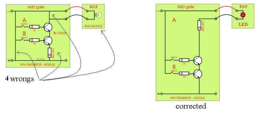

Starting out with electronics - simple circuit, does not work

Please note that the load ( Led and it's resistor) must be placed before all NPN type transitors.
4 wrongs with the below pic.
No wonder you are confused.

I thought it didnt matter where the resistor on the collector/emitter goes, since Ic=Ie

I thought it didnt matter where the resistor on the collector/emitter goes, since Ic=Ie?
With PNP type, the loads (Leds and it's resistor) are place after the transitor.
When you learn how to use your parts correctly, then you can start to use math formulas.
