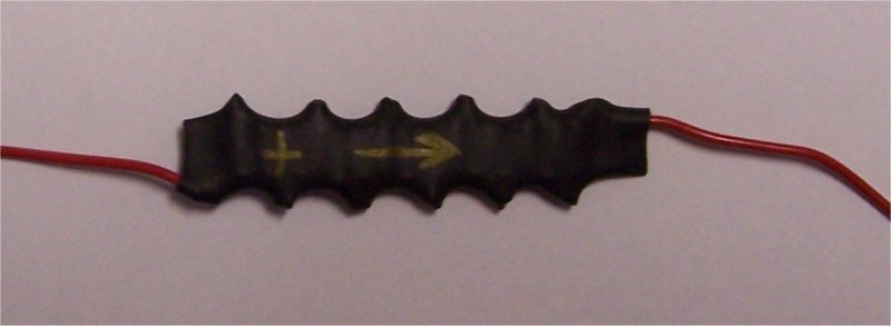

I did exactly that, reducing the voltage of the car to use a computer amplified speaker that is running at 6 volts.
I soldered 11 diodes in serie, I think it was some 1N4001, and it is reducing the voltage to around 6 or 7 volts, enough anyway for the speaker to work well.
Alain

I'm very surprised you get acceptable audio quality with that many diodes dropping the main voltage. The current on an amp is going to be fluctuating which will vary the current through the diodes and their forward voltage will drop causing feedback.

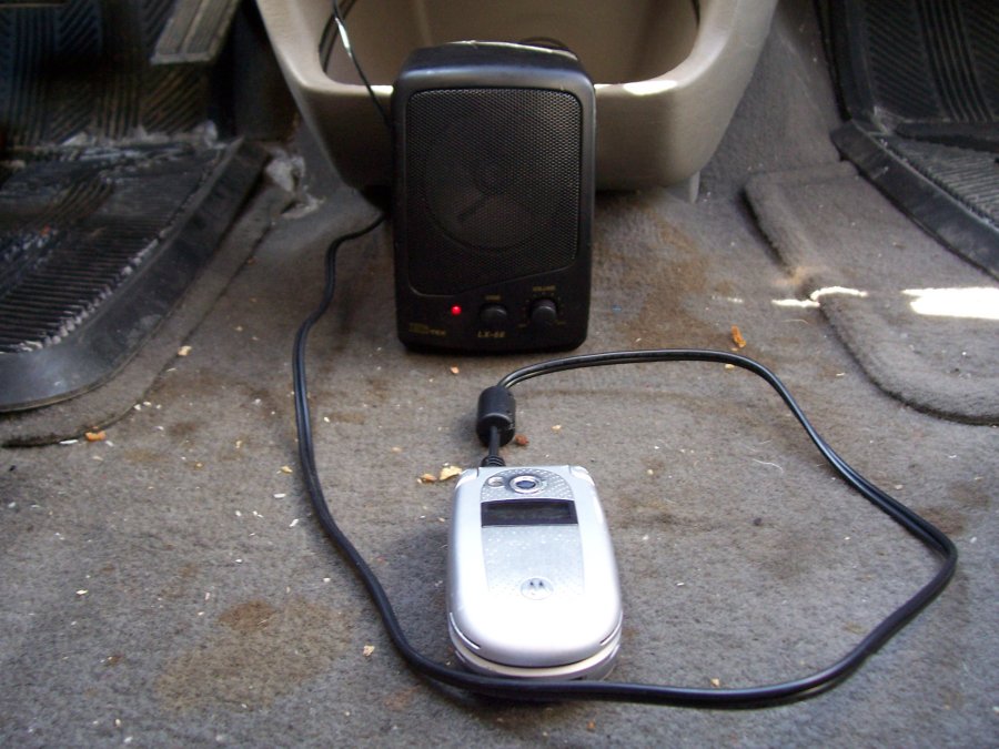

I can't comment on that. I am using the speaker combine with a microphone as a hands free system for my cell phone. I keep the volume fairly low to avoid feedback through the microphone. I use it every day and It is working well for me.
Alain
Edited: On that system, I used 10 diodes, not 11.
I doubt that would be a problem.
If the amplifier has good enough power supply rejection and a large enough capacitor connected across the supply, i.e. it's well-designed, that shouldn't happen.
