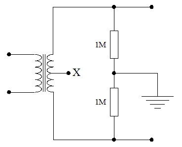

I really can see your point about isolating the power supply from earth but (as listed above it does have its disadvantages.
Here's my suggestion.
Both conductors are connected to 0V by high impedances.
The voltage at point X is monitored with respect to earth, if it's greater than 0V by more than a few hundered mV then the circuit breaker will be tripped to isolate the circuit.
The main advantage this system has to the usual RCD is that normal power supply filters should cause it to trip because they contain equal capacitances to earth from each conductor so it should ballance.
