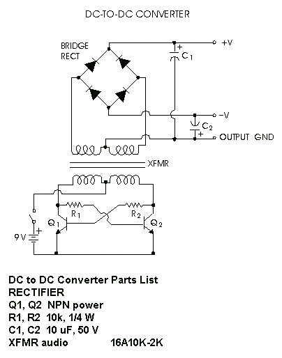

Hi ppl,
does anyone here has any circuit for stepping up a voltage circuit from 9.6V battery to 12V?
Pls give me a reply, help really needed...
Thanx ppl!
Seach for "boost converter". Lots of practical circuits on the internet. There are ICs which do the job too, within specified voltages and currents.
It would be easier to add 2 rechargable D cells in series with the 9.6v and add a voltage regulator to get an even 12v unless the .6 doesn't matter.
Here is one way to do it.
How much current?
If you can tell us how much current you need at 12V it would be extremely helpful. There are a couple of circuits that I am aware of, but knowing the current makes a difference in the design parameters.

Hey ppl, once again thanx for givin me ur replies...
about the current needed it would be about 0.5mA...
and also k7elp60 do u have the circuit...if u dun mind can u send to my email hiuyi_87@hotmail.com
