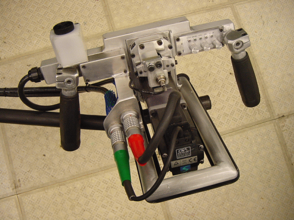

i used servo, it's extremly precise and fast (two seconds from full left to full right):

System in a picture above was designed for industrial application
that needed to run at very high speed, torque and precision.
Torque was limited to max. 22Nm to prevent damage to the car.
Normal operation torque was ca 15-18Nm. Torque was this high
because operation happens before power steering is functional
(and before steering wheel is installed, that's why the unit has
handles so operator can manipulate the unit and mount it on
steering column of tested vehicle).
I was using Mitsubishi components because that was customer requirement:
Servo Drive MR-J2S-20B1
Servo Motor HC-MFS23K (200W, built in high resolution encoder)
Motion Controller QD75M1 (installed in Q PLC) etc.
Motor was coupled with 30:1 gear ratio (10:1 gearbox plus
additional 3:1 gears since the lightweight gearbox wasn't available
with higher ratio).
One of the limitation was weight (it had to be less than 6.5kg for
whole unit) and you can see that big part of the system is made
out of aluminum and composite materials.
For your application motion controller might be an overkill.
