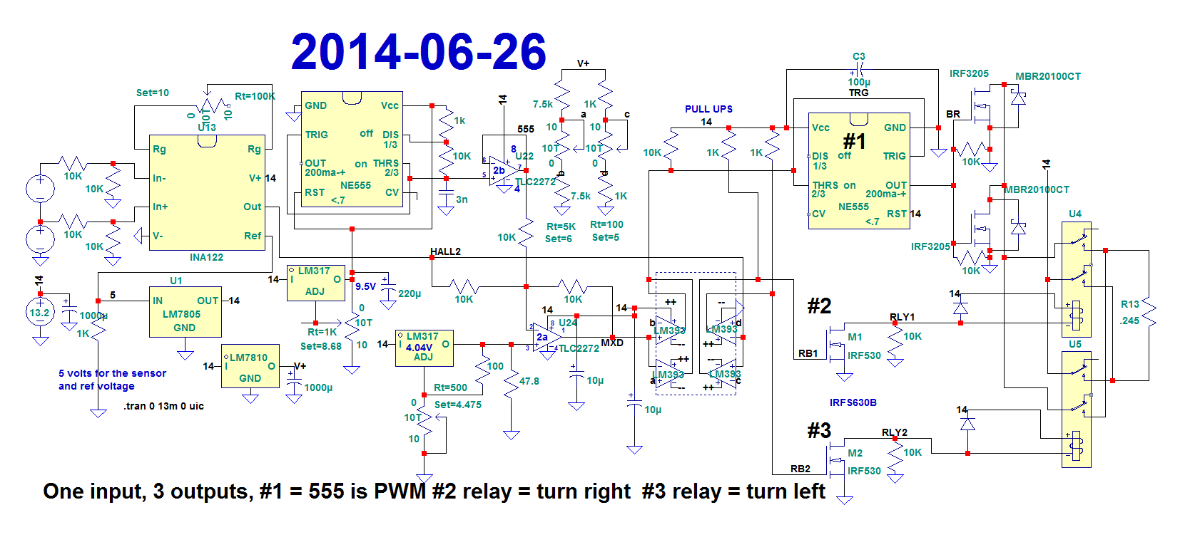

I've tried multiple gate drivers, IR2110, totems, and last try was the output of a ne555, but my IRF3205s keep dying, Last kill was, using the uploaded drawing, apply the PWM to a gear motor, 12v 185 watt, one shaft having a sensor similar to a Wheatstone bridge and the other shaft is power output. I held the output with some pliers a while turning the input shaft and watched the current from my power supply, with 2 IRF3205s in parallel, I should have over powered the supply and should not have been able to stop the gear motor, instead, at about 15 amps, one of the IRF3205s failed shorted, again!

If you need a better explanation of the circuit, let me know, but it is a power steering assist for off road vehicle.
The setting in the circuit allow for timing the PWM and relays so that the relays energize before the 555 gets the trigger and loses the trigger before the relays drops out.

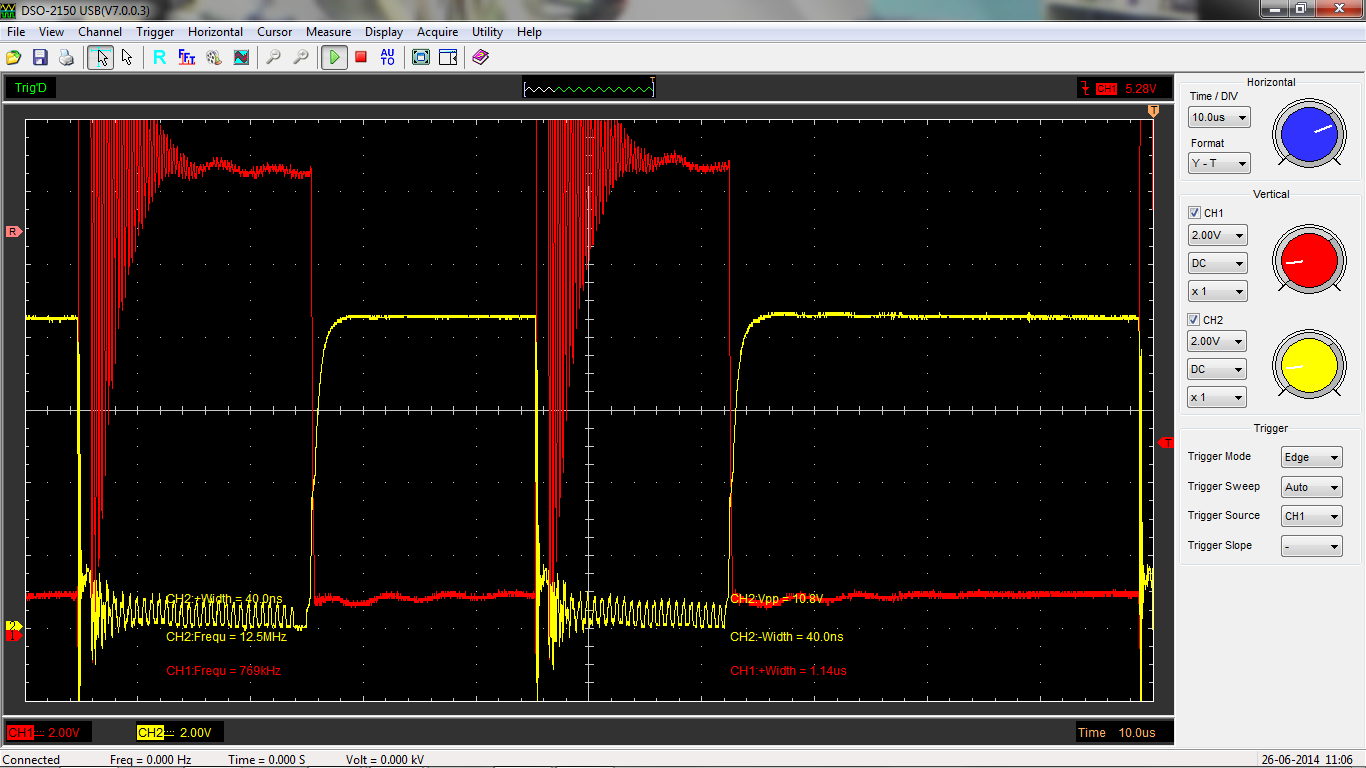

#2 the inductive kick back was very close to the voltage rating, My scope measure it at just over 50v p-p and my Fluke was saying 24 v. I tried a IRFp460LC, 500v, 20a, RDS(on) = .27Ω and it had an inductive kick back high enough to take out the 400 v 10a diode. My scope measured the p-p as over 400v and as I would increase the demand, it started making noises, so I didn't push it very hard.

So now I'm wondering why my protection diode wasn't keeping the kick back voltage down. Do I have it in the wrong place.
This is a bad scope shot, as I would add more demand, the oscillation would disappear and square off at the oscillation ~24-50 v (red trace) (yellow trace is gate)

Your Diode may be Ultra Fast, But it Breaks down at 400 Volts.
Your Mosfet is rated at 55 Volts.
So the Mosfet is probably trying to Clamp the Spikes.
Ideally your diode should be Ultra Fast at 50 Volts, so it Clamps the Spike Before exceeding the Max voltage of the Mosfet.

Eh ? It should clamp the reverse spikes at its reverse voltage. Probably ~1V to 2V
It is capable of spikes of up to 400v before being damaged.
You may be confusing the clamping diode with a zener diode.
The speed of the diode is also important as if your spike is a fast one, the diode won't clamp until a higher part of the spike voltage exposing the protected item to a higher voltage.

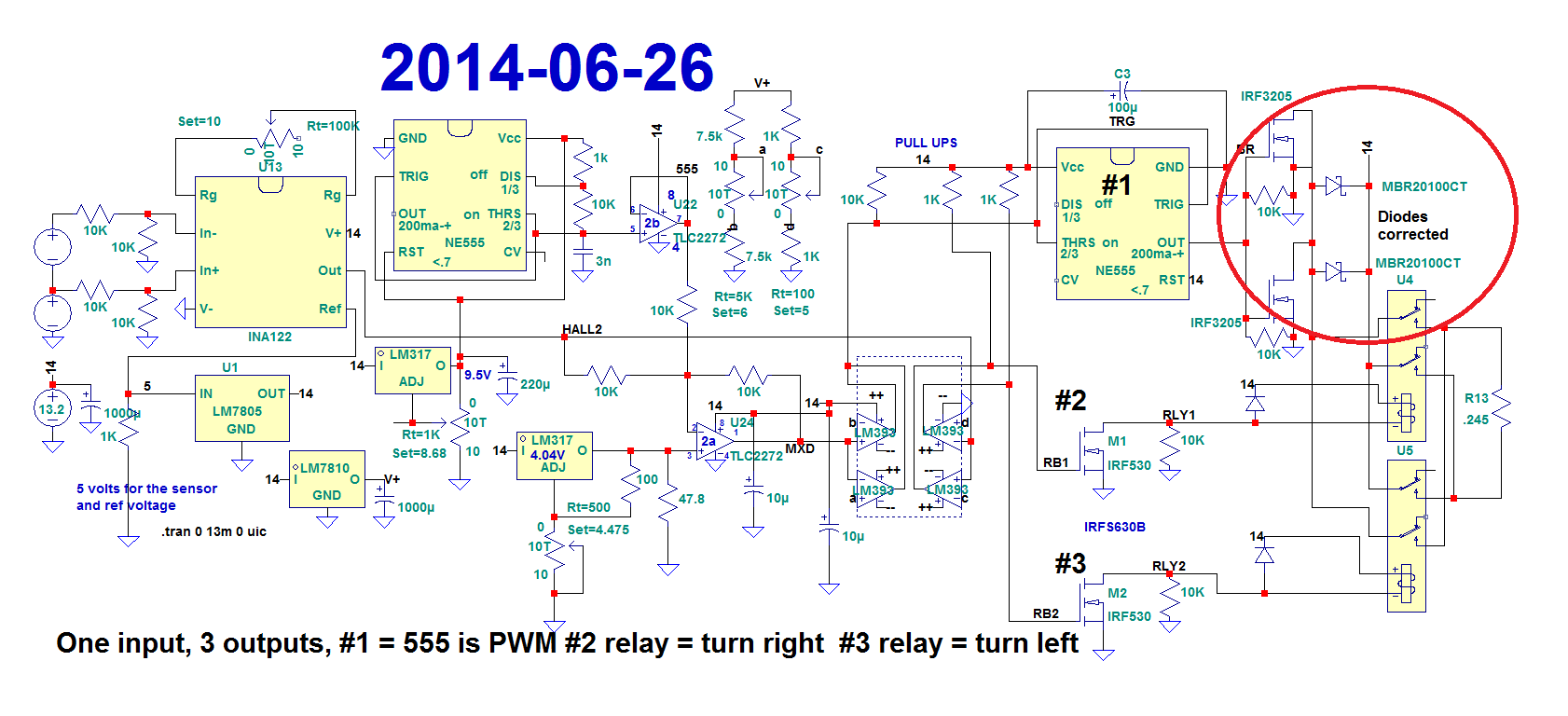

Yep, the diode's in wrong, needs to be cathode to +14 & anode to drain.
Some where I read or someone said that the body diode was sufficient for back EMF, I think from what I saw on my scope is if you have a 55 volt FET, you'll get a 50+ volt kick back voltage, If you use a 500 v FET, you'll get a 400+ kick back, high enough to kill a 400 volt diode that's in wrong, just the way I see it.

Interesting development, after putting the diodes in correctly, I could not hold the motor torque at much above 5 amps, before, I could hold it back at 10 amps.
made it through the day WITHOUT killing any FETs, :happy:, put the unit on my vehicle and I am getting it tuned in, if I can get it set up, it will be easier than the store bought unit.:woot:

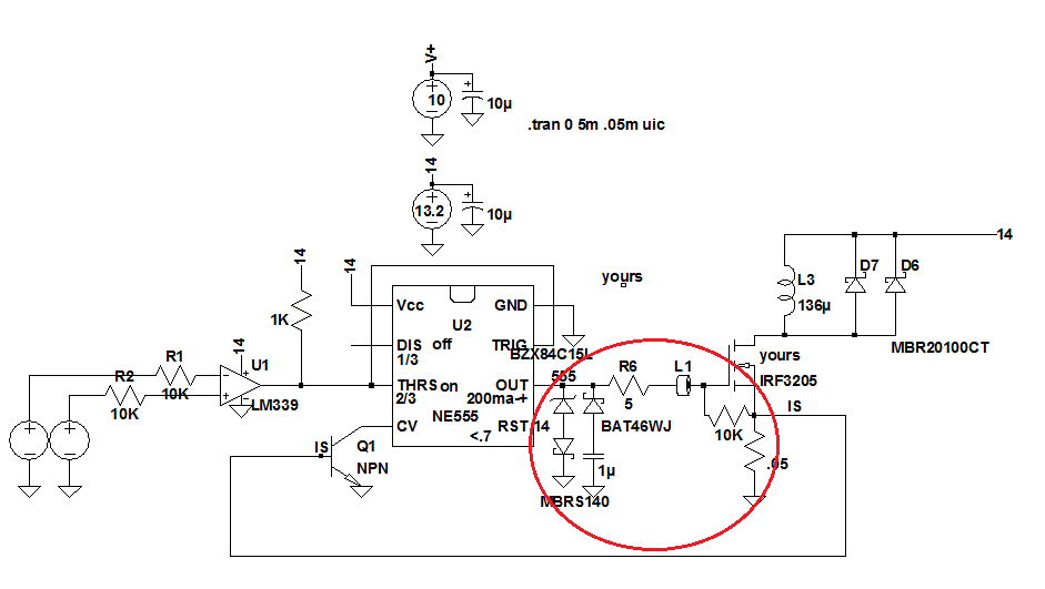

Mosaic, Is this the set up you were talking about?
I have used feed back to CV of the 555 in the past and I worked well, If I use feed back as shown in the drawing, do you think it will work? or turn the FET into a heater. Spice show the feed back to CV creating a high frequency which should cause high switching losses.

The schottky and 1uf film cap go from Drain to ground, effectively bypassing the FET avalanche.
Due to the high avalanche currents I had to deal with, the freewheel diodes would burn up as they tried to clamp at under a volt. I was pulse discharging (500Hz) a 15Kuf LOW ESR cap bank into an RLC load.
The 1 uf film cap ESR and heavy duty pulse 50SQ schottky formed a DC blocking path for back emf which permitted clamping at about 45V based on the kickback currents. This is below the avalanche voltage of the FETS I had. Avalanche happens at around 10% greater than VDS rating.
I tried to use a heavy duty TVS diode rated at around 40+ V but it popped after a few minutes.
https://www.newark.com/littelfuse/1-5ke43ca/tvs-diode-1-5kw-43v-do-201/dp/17H2660
Clamping backemf at a higher (but still safe) voltage reduces the pulse current load on the freewheel diodes.
The capacitor pulse bank absorbs the back emf.
The control voltage needs to be smoothed in order to modulate the pulse width properly.
You need a pi filter to produce a variable DC voltage for the CV from the PWM current in the sense resistor. Also you'll need a collector pull up resistor to provide a load for the transistor drive. You'll want the base drive to vary between 0 to .6V and you'll need to calc the base current for a base resistor as per the HFE of the transistor and the Ic as per the collector pullup resistor. You may need to bias the base with a voltage divider to get things to work properly. If u have a good spice transistor model you should be able to whip that up pretty quick.
