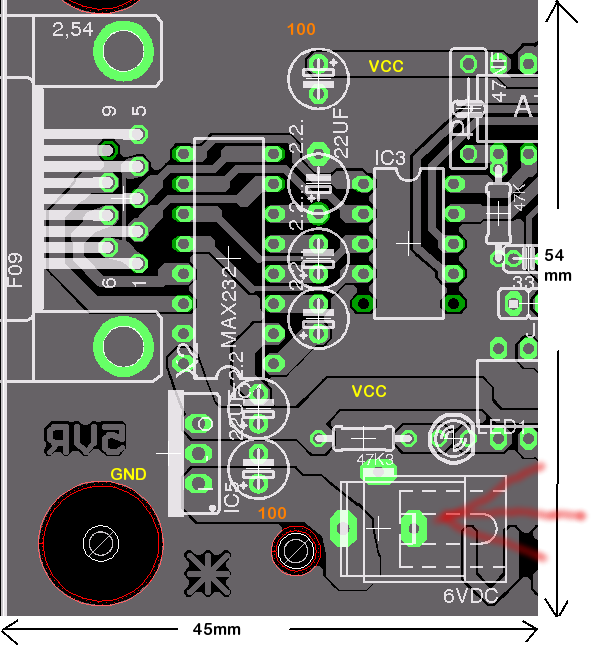

Why didn't you show the hole board like how is the battery hooked up
You say it works find on battery you got something wrong with the regulator setup probably some thing backwards.
I attached the same connector to the batteries as the wall wart uses to plug into circuits.

You plug in 6 volt battery at red arrow
Yor regulator maybe backward that's why it works with the batteries
if the volts not to much over 5 volts the regulator will output backward i had some from years ago
lm7805 that was output on the left gnd then input they would try to block if voltage was 3 or 4 volls higher
I was like whats going on power not right i figured what the heck un soldered it switched it around bang it worked never tried batteries tho but 4 AA i bet would pass if the draw not to high I do no they will if the load not that much. And voltage close to the dropout
That I am already doing.
Your regulator maybe backward that's why it works with the batteries
I double-checked all connections and they are correct. In fact, I go so paranoid that I sometimes use a utility knife to scrape off random green non-conductive material that sits between the tracks. this is because I dont want to see VCC and ground connected together by a tiny track that wasn't part of the PCB diagram.
lm7805 that was output on the left gnd then input they would try to block if voltage was 3 or 4 volls higher...
I read the datasheet to determine how to connect it. I don't want to gamble by flipping it and again, I'm using the LM2940-CT regulator, not the 7805.
I think the regulator is right. Not backwards.

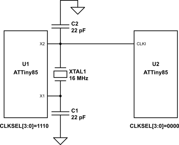

Ok I seemed to have fixed it.
My micro to micro setup of sharing a crystal is like the following (except I use at89C4051 for the micros). Initially I had C1 as 33pF, nothing for C2 and the crystal as 22.1184Mhz. C2 was nothing because I was depending on the PCB itself to produce capacitance. I did however make the tracks at least 50 mils thick (yes I do alot of things thick since today's printers are $**%.) for the crystal so the board won't heat when the signals go through.
Now I put two 10pF capacitors in parallel (to make 20pF for C2) and things worked both for battery AND the unregulated wall wart and this was tested without the need of the additional 1000uF that someone suggested as the fix.
question is tho... is 20pF 100% acceptable or should I change the value? I deliberately made it lower than 33pF because I heard that capacitance increases where xtal1 and C2 meet up because more micros are connected and each pin has capacitance? but I don't know the math, but at least the addition of the 20pF was a help.
Firstly, make sure you have Xtal2 (pin 4) of the master oscillator connected to Xtal1 (pin 5) of the slave oscillator. The capacitors are on the master oscilator and Xtal2 is not connected on the slave oscillator.
What are the specifications of the crystal? Load capacitance, package shape etc. How far apart are the two microcontrollers?
The capacitors are there to provide stable operating conditions for the crystal. C1 provides load so that current can flow in the crystal and C2 helps to smooth the fast edges of the inverter switching. Without suitable conditions the crystal won't oscillate. In your case I suspect that noise from the power supply caused unwanted oscillation which prevented the crystal oscillator from starting. The capacitor reduces the noise and allows the oscillator to work normally.

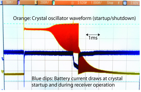

The crystal will take up to about 1 ms to start up. At start-up, wide-band noise is being amplified by the oscillator amplifier, and the crystal only allows through the correct frequency, which gains amplitude until the amplifier saturates. If you look at Xtal1 or Xtal2, with an oscilloscope, there will be no visible signal for more than half of the start-up time, before the signal amplitude increases exponentially. During the early part of start-up, the circuit is very sensitive to noise.
This shows a typical crystal oscillator start-up:-
You can get an unwanted oscillation that starts up much faster and prevents normal crystal operation. You can even get the situation where if you touch the crystal connections with a 'scope lead, the oscillator starts and is then stable with the scope lead removed.
