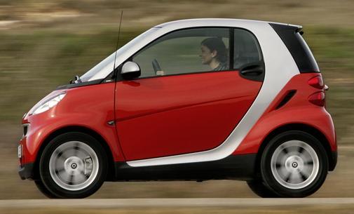

Cars in Canada must meet crash regulations so that toy 3-wheeler in India is not allowed. I am surprised that the tiny SMART car meets the regulations but it is very expensive for its size.
