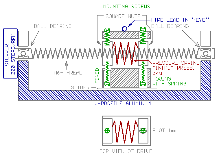

the downside of the coil winder is a precise traverse drive which can get pretty expensive using acme drive spindles.
Here is an easy way to overcome that problem.
All you'll probably need is a six-pack of beer to "bribe" your local locksmith. :)
The M6-thread has a pitch of exactly 1mm per revolution. Based on that and a stepping motor with 200 steps per revolution you should be able to wind precise coils with a wire diameter down to 0.005mm with no backlash!
Here is the construction idea: Any nut on an M6-thread will have a backlash of at least 0.5mm, which is by far not precise enough for a precise coil. :(
Using two nuts with one fixed and the other one moving spring loaded the backlash will be zero - provided the spring is strong enough.
Here is a sketch of the construction, also showing you what you can do using Eagle instead of astronomically expensive machine design software. :D
If there are any questions concerning the construction details don't hesitate to PM me.
I'll be glad to explain more details (which should be clear from the drawing)
The first experiment was pretty promising with almost no backlash on a primitive device. (5/100mm)
Regards to all
Boncuk
P.S. Scaling must be done according to requirements.

Sorry to read about the price (US$215). :(
It's even more expensive than using an acme thread for precise positioning.
Members want to build a precise, but cheap coil winder which will not be used every day.
My solution will not take more than a six-pack to build it if you're lucky. :)
Please compare and tell me what would be your decision.
Regards
Boncuk
your design of the double nuts is "excellant" ! you have recreated the lathe and mill feed screw adjusters that have and still are being used to day for at least 100years :) my old leblond metal lathe from 1923 had them.... (you know it works when you find out its already been done. good job though and never stop learning :)
Hi Joe G,
when I got that idea I certainly didn't know about the leblond metal lathe.
I also didn't intend to re-invent the wheel.
I just experimented a bit to have precise drives for my solar tracker which follows the sun when the sky is obscured for full power output of the panels as soon as the sky is clear.
Nevertheless I guess it wasn't a bad idea to post this simple mechanical solution for the coil winder.
