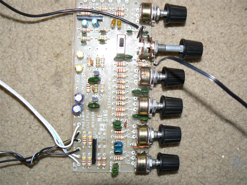

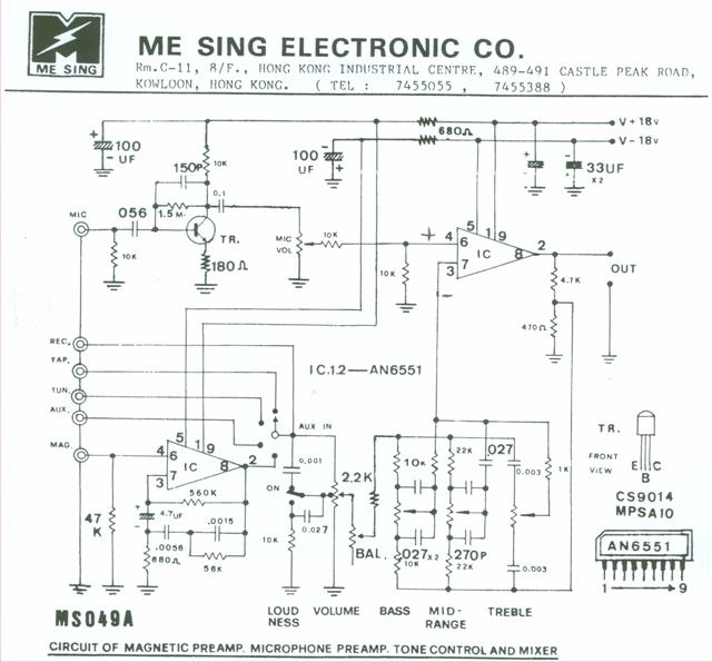

I built the preamp (2 channel) utilizing the AN6551 chip. the unit works, but it makes noise like I'm touching (with my finger) the input wire. the only way to stop the noise is to touch the ground point (0 volts). regardless of volume Pot setting. I am at wits end now, any Ideas? I've included the schematic. I am using a 15_+ (differential 30 VDC) regulated power supply.
OK I found the unit has to be enclosed in a metal housing, grounded. This stopped the noise.
But now the unit periodically "POPS", as heard through the output. Any Ideas on that?

If it is in the circuit, you will need to upload a schematic though.
I did upload the schematic, it's a thumbnail that can be enlarged. Take a look. When I touch the ground circuit, the amp silences all noise, and works perfect.

Which is why I asked for a picture of how it's built - it sounds like you've not grounded it correctly?.
Maybe the 0V from the dual polarity power supply is not connected to the circuit's ground.

Can you take a picture of the board and upload it.

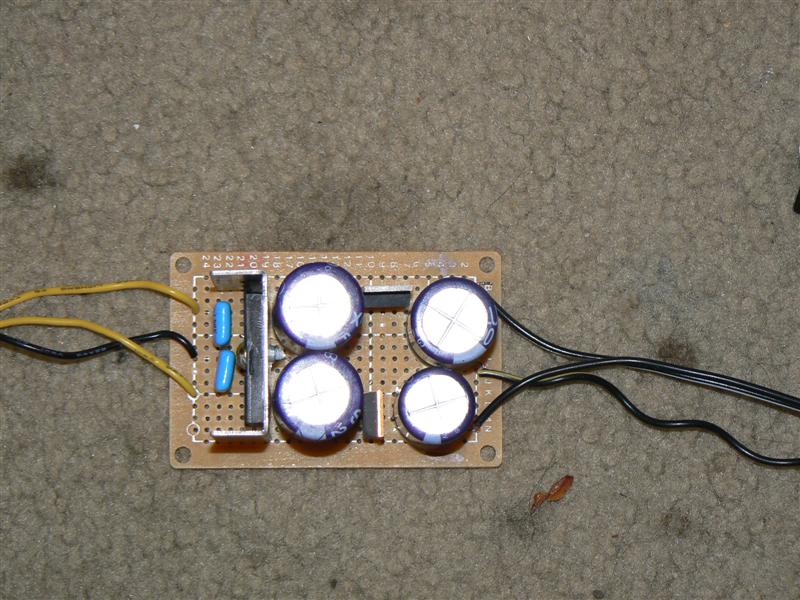

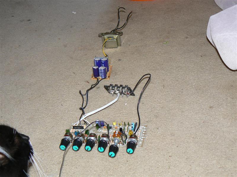

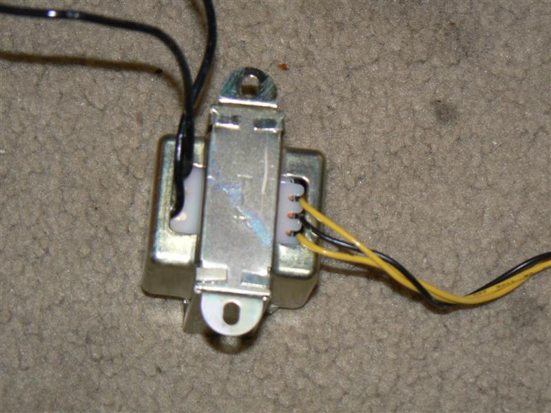

P1000414 (Medium).JPGThanks for all the replies so far. I have uploaded 4 photos of completed unit. The Center Tap from the transformer runs from it all the way to the circuit boards ground point (0 volts) even through the regulated P/S.
You may want to research the term and applications of 'star' grounding methods. You have very long common run from the transformer CT to the common on the PCB. Typically an audio application will place the common 'star' grounding point as the common connection of the two main filter capacitors. Here is where you will run wires to all load, input and out connections that require a common. You basically are most likely fighting a 'ground loop' problem that is very common (pun intended!) on low noise audio applications.
I see the photos are taken on the floor... does the hum change in different locations? A sensitive amplifier sometimes needs to be shielded - Try setting it on a metal plate (with insulation). Metal plate connected to your signal ground.
Hey thanks for the Info. My P/S is using 2, 3300 Mfd caps, one Pos one Neg and in the middle ground or 0 volts. then the board has 2 Caps, 1, 470 uf and 1, other 470 uf (I replaced the originals thinking they were causing trouble), both referenced to ground, 0 Volts.
I put the unit on the floor just to shoot the pix. The location of operation is on a card table, made of particle board.

WOW, I'll be damned, I placed the unit in a baking pan, Insulated and grounded, and it is very much quieter, except now it pops alot.
Something like that should be in a solid metal housing and well shielded input and output wires.
