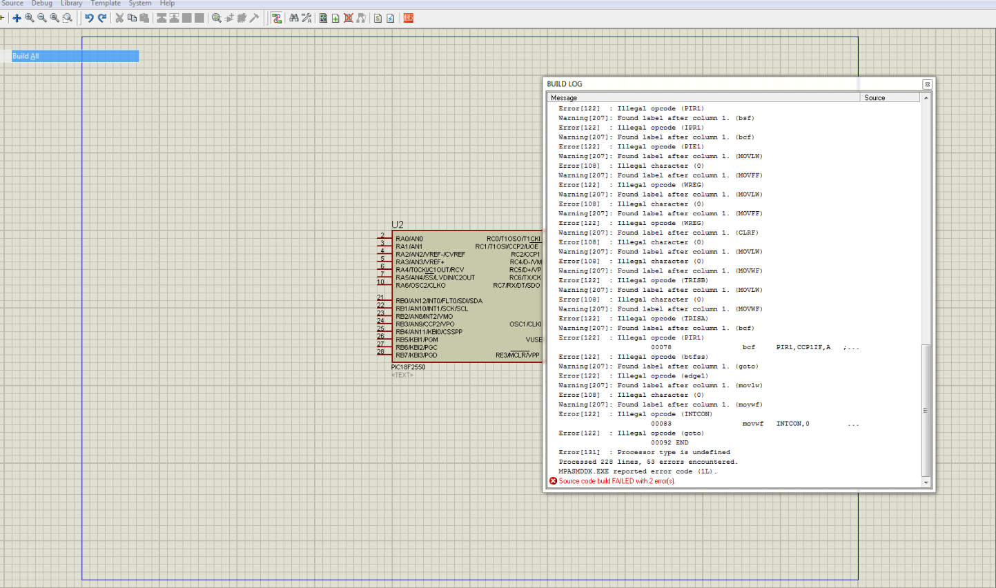

I am trying to get my head around ISIS, i am almost there but am having an operational issue which is something to do with an operational oversight of mine but i cant figure it out.
Using the code above..
I have selected my Micro (the same one specified in the code) attached the HEX file to it so that the machine code is recognised by the micro, attached the source code in the .asm format, (both written in/generated by MPLAB)
but i keep getting the same list of errors, which clearly cant be because the code compiles and runs fine as you know, and i have verified the same in MPLAB (although it does not capture when using the stimulus workbook but we already knew that!)
a warning/error on every line what am i doing wrong?

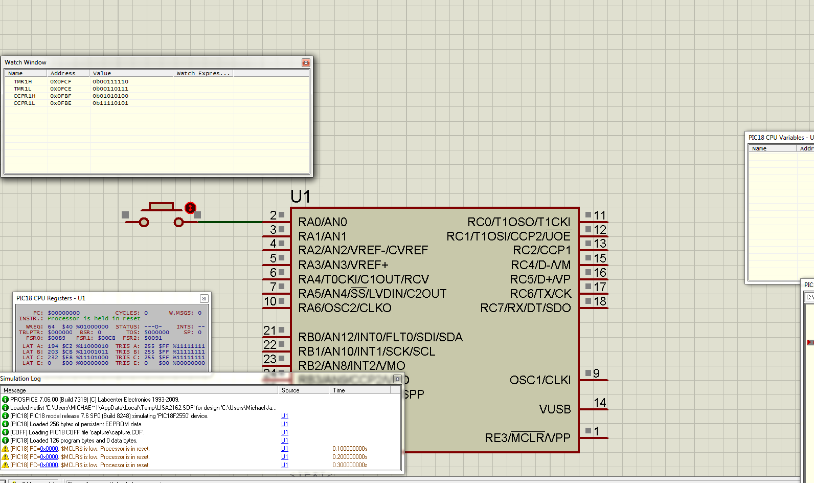

the .HEX file didn't work but the .cof file did,
Though with the button it seems like the timer does hold a value but fails to update..
Theres no reason i can see that the processor seems to be in reset continuously according to the simulation log
:D finally... should've spotted that!
Its working fine now and actually allowing me to walk thru the code! The CCP1 register isn't updating (says disabled in the watch window) but the timers are doing what they should, so im going to go thru the code snippet again. Thanks!

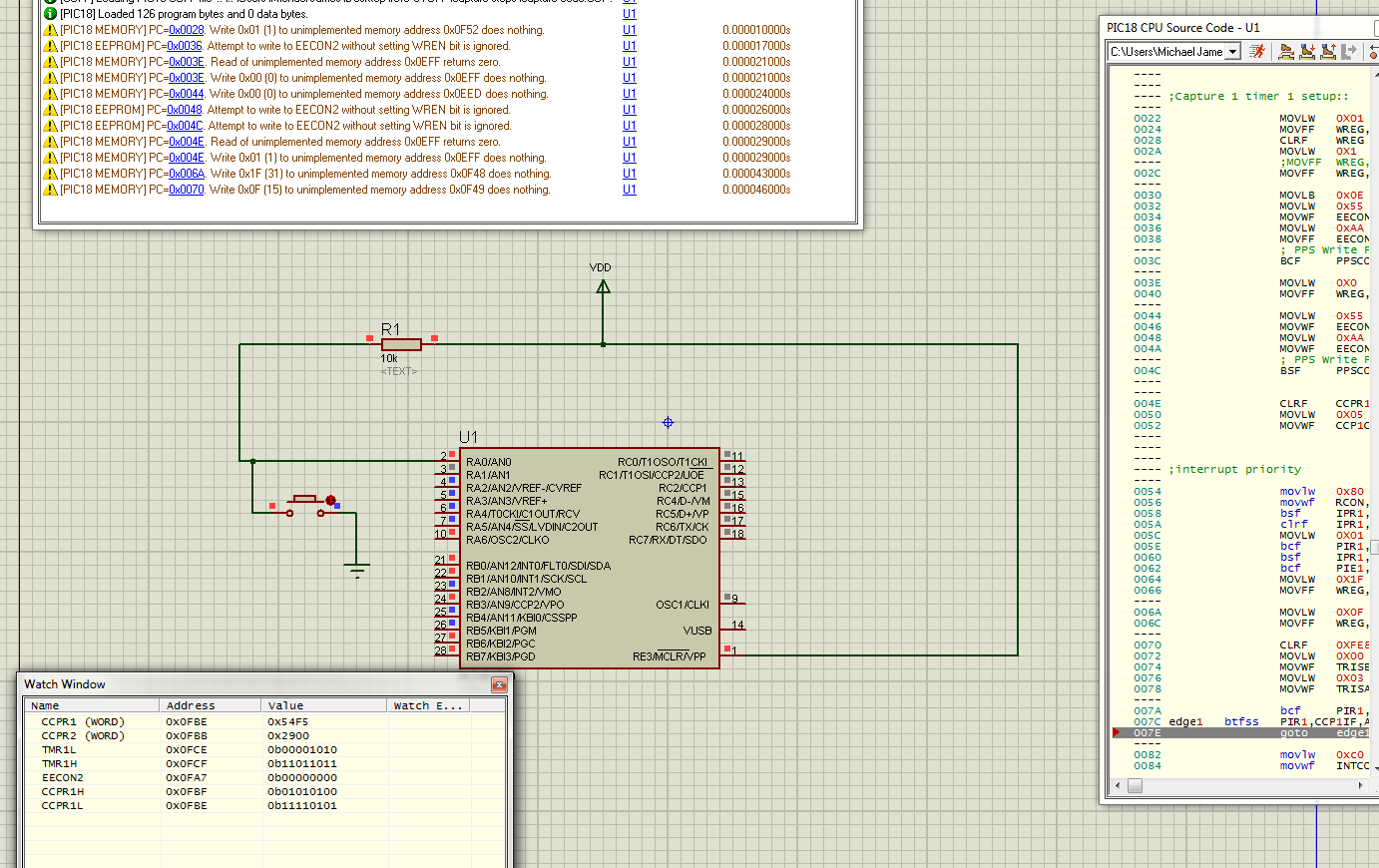

even when i regain control of ISIS the values fail to change from their initial value, i have the button tied to VDD too for the input voltage and definitely input on the RA0 pin, no change, im just going over the remappable pin section of the data sheet to see if there is some kind of code error in that department.
This is the arrangement im using at the moment
Are you using the same code as I (accidentally) posted?
Incidentally... You need a pullup and switch to ground..
Mine has stopped just after the loop and filled the CCPRx register... After the button press.
yes I'm using exactly the same one, i figured i would make sure I've got to grips with the program using a code that i know is working.
That way i don't need to worry if the errors are with the code or with my knowledge of ISIS.
Ill give it a try with the pull-up now
it doesnt seem to make it passed the first capture stage, meaning it isnt reading the input on the RA0 pin.
Even with identical codes and now circuitry.
it does strike me that your additional pins 21-24, are seem to be showing a blue square (which i assume is a low logic) which would be correct but mine are showing a mixture,
im thinking there may be some configuration bits setting that im unaware of, that may also explain the warning messages that i get too
