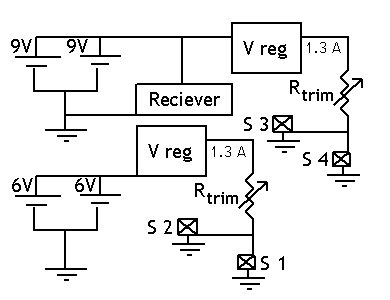

The 7806 Looks like a great Idea, I have also looked into the LM7808 as well as some adjustable voltage regulator ICs. The only problem is how much current do these regulators waste? I really dont know except thats some are considered low drop out and some have other current saving features (but not the 7806). Here is a wiring diagram in jpg format that might shead some more light on what im trying to do, please keep in mind this thing must have both the right and left tread motors on at the same time to go straight. S1,S,S3, and S4 are the servos for right tread, left tread, pivot, and griping arm respectively.

9V batteries are usually less than 300mAh whereas a C cell is nearly 7800mAh. I would opt for the C cells driving the servo motors. Using the parallel combination at 6V would allow you to directly drive the motors without the losses of a voltage regulator (though the speed/torque would decrease as the batteries ran low). The motor current required (0.68A) is not too high for C batteries. The total power in 8 C batteries far exceeds what you would get out of 2 9V batteries.
I would recommend you to go with the 6V pack.... so you don't have to waste anything with a regulator. And the normal R/C servos will take the 6V easy.
:idea: What I've done in the past, to get more speed, is to remove the circuitry inside the servo and made my own controller. This way I have power those servos at 8.4V. I used one of those L293 SMD to make it small enough for my application.
