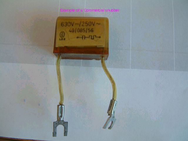

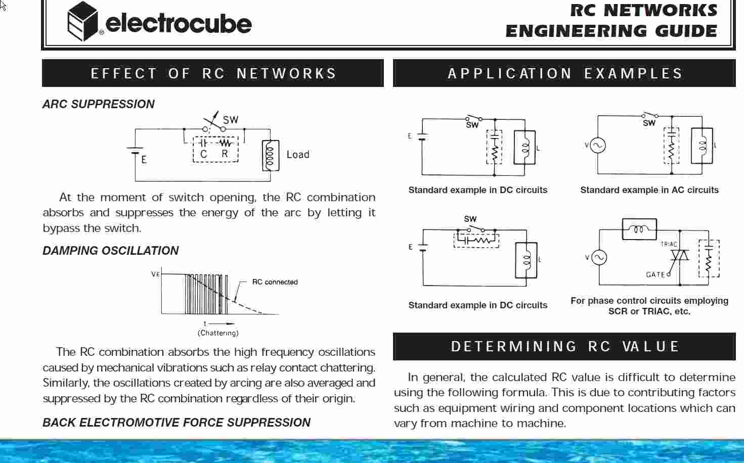

Here is a R/C 'Snubber' used on AC contactor coils etc.
Max.
