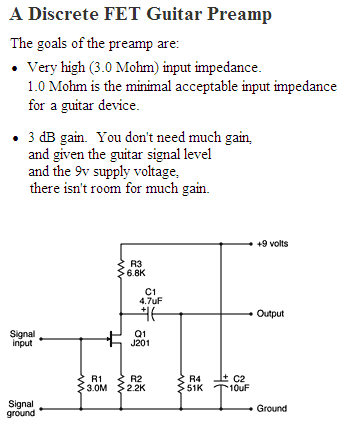

Here is a previous thread that 'splains what is going on.
The OP has a circuit with a coupling capacitor feeding a 1M resistor to the bias voltage and the Jfet input of an opamp.
It is very similar to a guitar pickup preamp.
