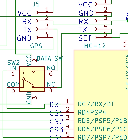

I have a PCB where two serial DATA SOURCES need to be alternatively switched to an RX INPUT.
I used a MAX4644 for this.
It appears to switch ok,when series testing, but when there's DATA on either source the two sources appear to merge.
Any thoughts please?
Camerart.
Do you have a load resistor, eg. a pullup, on the MCU RX input pin?
That may be needed to avoid stray inputs or noise.
I'd try something like a 10K and see if that has any effect. If you are still seeing both, it suggests a faulty device or wiring problem.
The signals are 3.3V RS232 e,g, NMEA sentences from a GPS module.

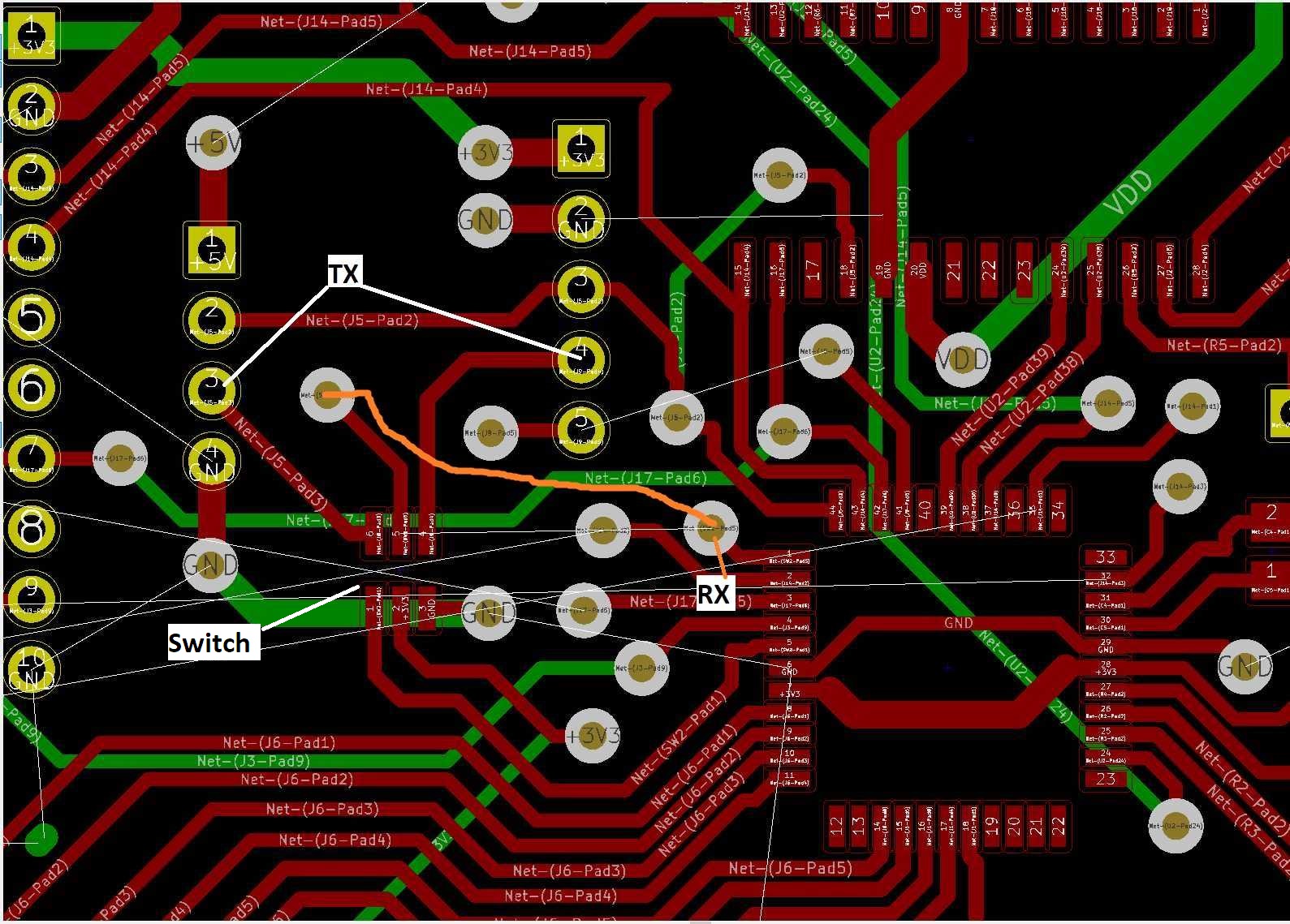

Here's a section from the PCB drawing.
I'll try a 10K resistor.
I'll look at the analogue type switches, if the MAX4644 doesn't look suitable.

The connector to the left of the switch IC shows a 5V power connection; if the data signal exceeds the 3.3V supply to the switch it will almost certainly malfunction.
You may need a resistive divider first to keep the signal within a suitable voltage range.

I personally don't see an obvious issue with using that switch.
But cameraart is right. If your gps is putting 5V into the switch and the switch is being powered by 3.3V, the ESD clamp diodes will conduct and possibly cause the behaviour you are seeing.

Correction: The GPS is supplied by 5V, but it's output is 3.3V as all the other modules on the circuit.
I did ask what would happen if the switch is powered by 5V and switched by 3.3V?
C.
Can you test by applying DC signals to one side that are 3.3V and 5V and see what happens? Or 3.3V and one of your modules?
Did you decouple the IC?
First test with my new/old scope, and I'm still getting used to it.
The switch input looks like it's switching ok 0-3.3V
Both inputs looks ok, and again 0-3.3V signal.
It look as though the GPS signal is showing occasionally at the RX PIN when HC-12 is selected.
I'll add decoupling caps to the 3.3V PIN and the switch PIN (Is this correct?), then re-test. Is this what's suggested?
C.
You should have those decoupling caps either way. Not sure if they are responsible for your issues though.

I added 104 caps to the 3.3v and the switch track, also changed to 5V supply for the switch. It seems better, but it looks like it's not perfect, although it's not easy to see.
Could it be the PIC internal clock? I received 8MHz crystals today.
