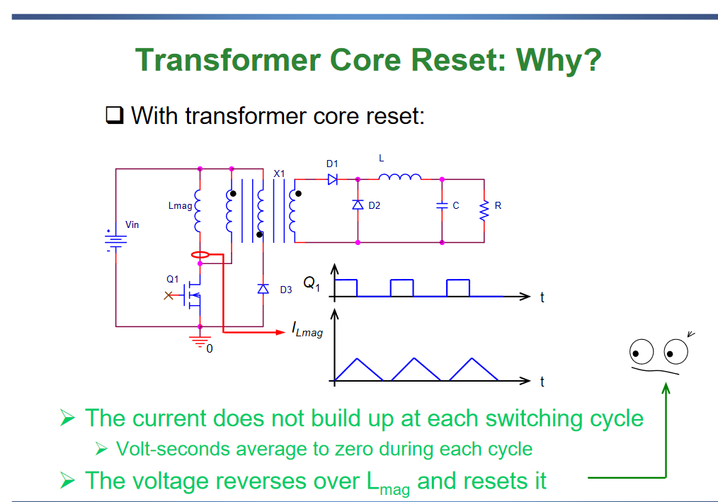

Added poly caps near reset diodes, parralel to 300V

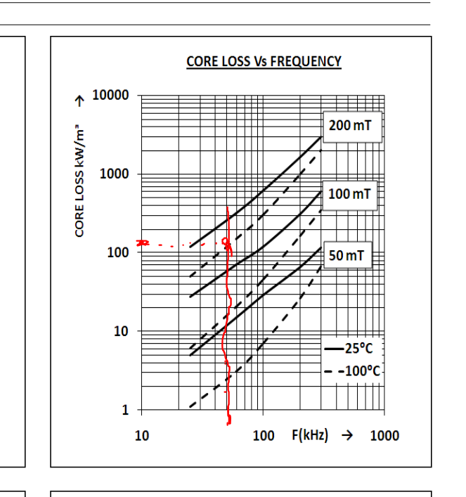

I just calculated that with 300V 50khz 50% duty cycle i am at 165mT
0.000024*150k = 3,6W

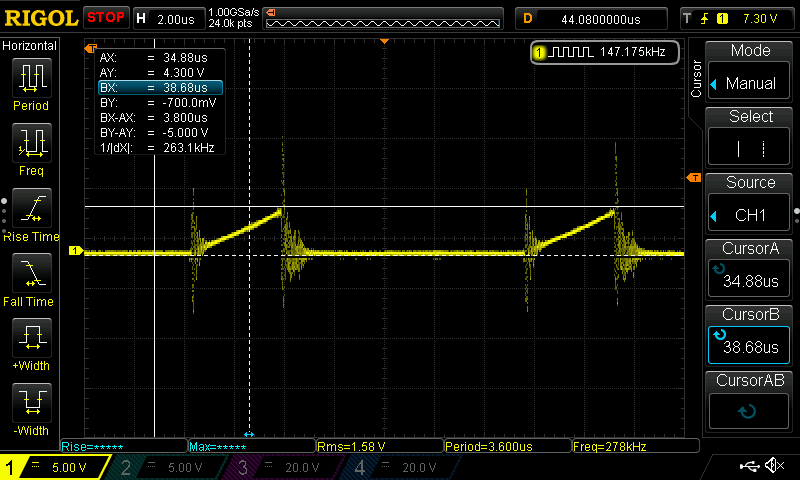

Some/much of the ringing is from the long wires to the transformer.
