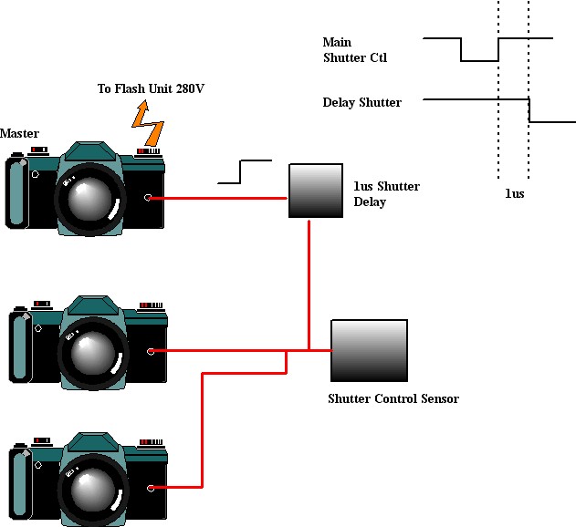

I'm probably not explaining this well. I don't want to delay the camera reaction to the sensor. I want to delay the flash response to the shutter.
I don't want to slow down the camera, just the flash reaction. It would be simple if Canon allowed "rear curtain sync" on non-canon flash, because then I could just make the flash trigger upon shutter closing instead of shutter opening.
HOWEVER, In principal - slowing the reaction of one camera's response to the sensor (ever so slightly) would also do the same thing. (Which isn't a bad idea at all)

Posted is an image of what my approach to your timing dilemma would have been. Let me know if this is off base. If it sounds feasable to you, I will post my circuit for implementing this.
P.S. I start school on Monday, so after that, my free time will be limited :)
I might be way off base here, but isn't the problem one of semantics? Aren't you really saying you want the flash duration extended so all cameras can capture the moment?
