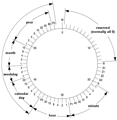

Can you post the actual waveforms showing the amplitude and periods coming from the DCF77.
Here are some details.
Will post some more as I find them.
and another.
I think the amplitude is reduced by 6db for the .1 and .2ms pulses.
edit. I may well have to put an inverter on the Output from my DCF77 module.
and another.

See details here and waveforms here.
Sorry I think I misunderstood your initial question.
I am using a module to demodulate the DCF77 signal.
Thats better, I see its not just a RXR module.
I was looking the 77.5KHz carrier'waveforms' that you posted earlier.:)
