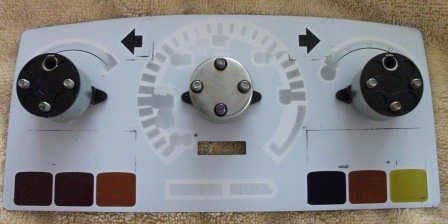

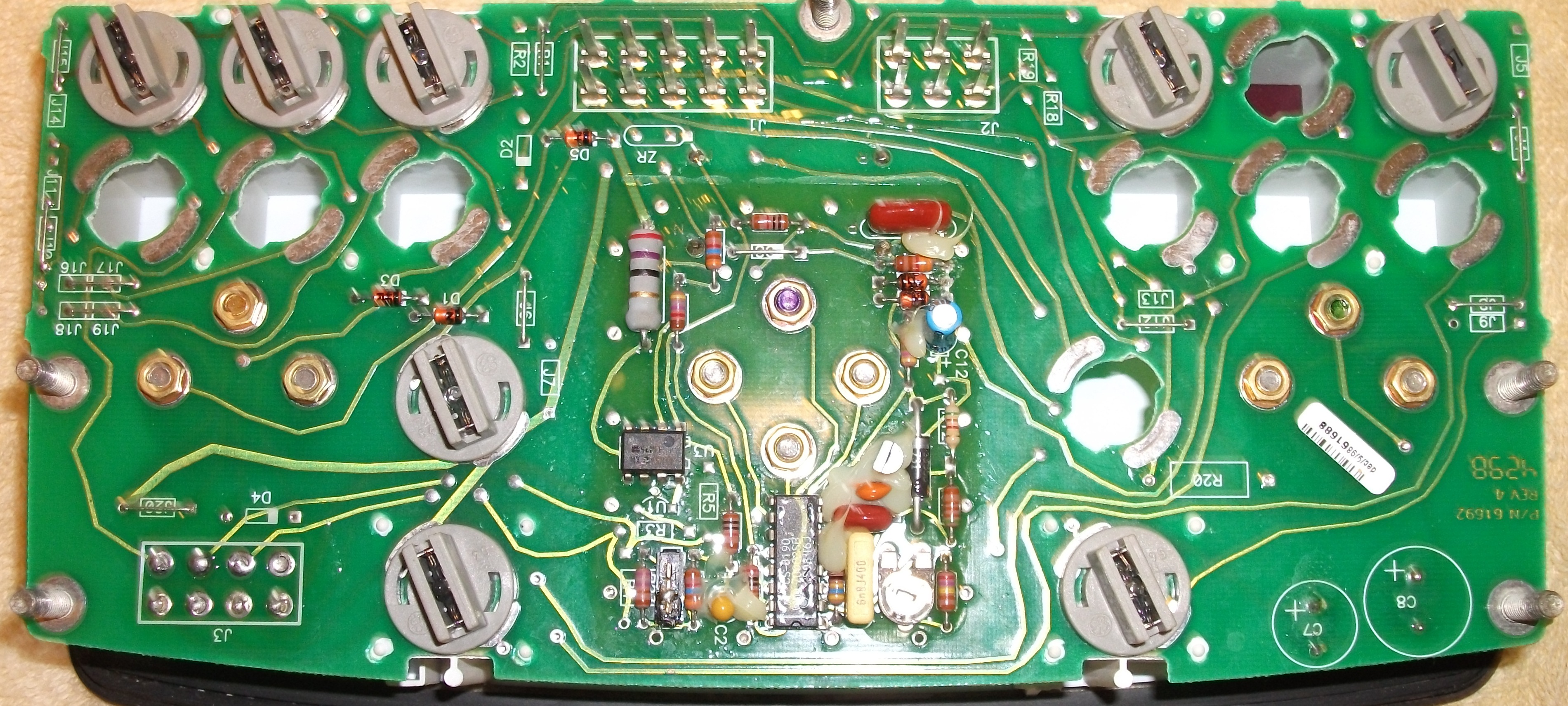

I have no farm livestock. It is in an enclosed building. The chassis grounds are clean and good. No moisture in the building. The problem is inside the tach. The cluster cost $455 nor do I have access to another unit. Any idea what component, diode, cap., resistor, ECU might cause the problem I described? While not the best I have attached a few pictures. The tach is in the center. Thanks.

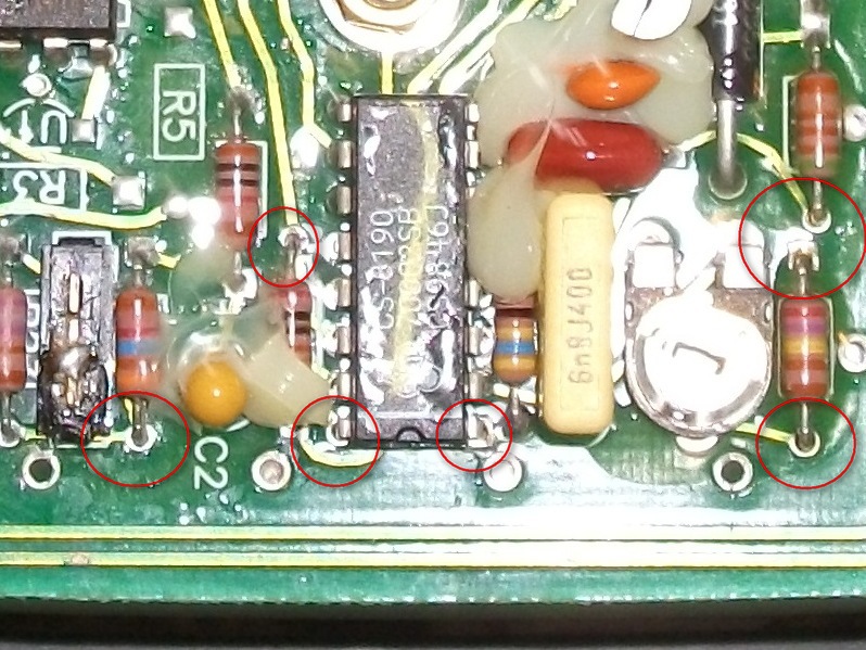

C12 (leaky?), the big resistor(dry solder joints?) (can't see a number) and the contacts under the nuts/washers on the mounting bolts might be worth a check.
Alec, I do not see any signs that C12 is leaky, but how would you suggest that I test it? I have cleaned the contacts (nuts, washers and circuit board, along with insuring the nuts are on securely). I will open it up again and re-solder the big resistor. Thanks
Don't test it - replace it. Costs fifty cents.
Another suspect part is that trimmer, on the bottom just to the right of the "6n8j400" yellow cap. That kind of open-frame trimmer is notorious for getting oxides under the wiper arm.
Is the trimmer a 10K or ? I had my ohm meter set at 20K. From my picture the top left (TL) to the top right (TR) the reading was 8.68. TL to center (C) reading was 2.12 and RL to C reading was 8.35.

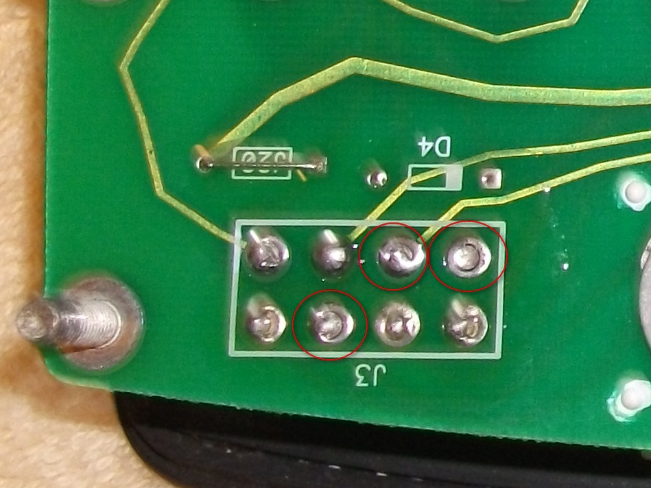

Can't see the other side of the board, but there are several questionable solder joints that need to be touched up. May be bad or just hasn't wicked though the vias. At least one of the crappy joints at J3 appears to sneak over to the center / tach circuit

pfofit, thanks for the close examination, I will touch them up.
The trim pot is unlikely to be the problem, it will be for calibration of the tacho. If you must take carefull note of where its set & just shift it slightly one way & then back. Dry joints realy need to be adressed.
I wonder if that small black or burnt component between the 2 resistor left side of C2. You might try to check it.
^ Yeah, what is that thing? Looks like someone took the body off a slide-switch and soldered the lower two contacts together.
my thoughts exactly when I first saw it, I wonder if it was the manufacturers easy way to produce a solder blob selectable mode. eg 4 cly / 8cyl or something
