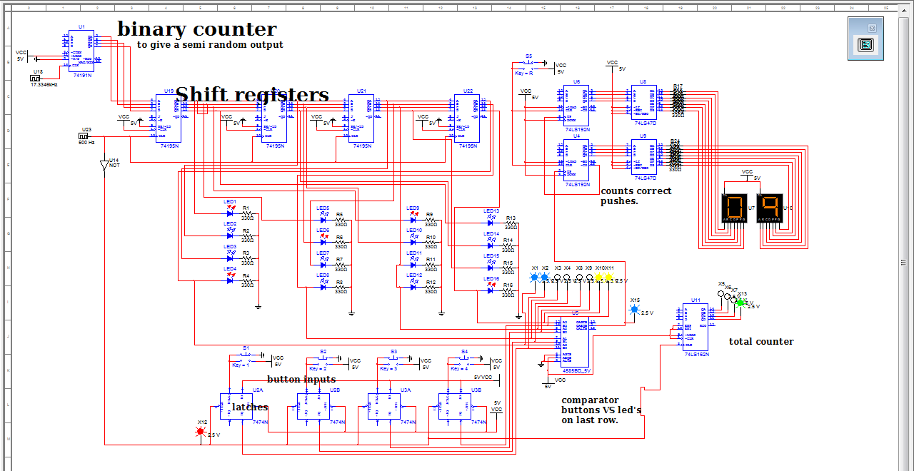

Im designing a project and im a little stumped on one feature i want to implement.
how can i take a percentage of 2 counter ICs? or even more elaborated, cascaded counters.
im using 74LS192 BCD counters and 74LS85 i believe is the binary comparator.
so how can i take counter#1 and check if it is 75% or higher out of counter#2?
and another problem i had was that counter#2 would always be 3 or 4 counts or clocks ahead of counter#1 because the way my circuit was designed.
i did think of taking NOR/AND gates to give a reset to counter#2 by checking if the inputs are 0000,0000,0011 (3 digit bcd) but just wondering if there was an easier way without all those zeros(so it doesnt reset on 13,103, etc..)

yeah, my idea would be that a led would light up saying this is 75% or higher, and another if 50% and higher
It would also help if you explain how the values in counters A and B are updated - especially whether there is a major time difference. For example does A only change occasionally and B frequently?
Yes. Counter A is based on user input, and counter B is based on a clock.
essential what i have is if the user pushes the correct buttons fast enough, they get points.
so how many did the user do correctly out of the total clock pulses.
as of now its infinite clock pulses, but i guess it is possible to set a fixed number of pulses and figure out how many their are. and then do the comparasion like that. but i do not know how to set a fixed number of pulses with 555 timer. actually yes i do now. lol.
i could send a signal when the total clock hits 100 or some number, i could send a signal to stop the timer.

i got an idea from somebody that seems like a good way to do it. Take the counter2 and subtract it from counter 1 and take that and compare it with 0. if more than 0 do this, if less than 0 do this.
something like C = 4A - 3B So when C>=0 the percentage has been achieved.
heres my circuit
i got what you want to make, i think 500Hz for shift clock is very high for human interface, also more than one button can give you a correct press in many instances. as i told you if you can make total 100 pulses and hold the counting like end of the Game, then the correct press display will give you the direct percentage.
I haven't studied your circuit in detail but I guess the intention is to light different LEDs at random and measure whether the user reacts quickly enough to press the corresponding button.
In my humble opinion this is a job for a micro-controller. One chip could do all of the functions of the several on your diagram - and easily allow you to change things if it was not working exactly as you want.

lol yeah i think its 500hz cause my computer was lagging in the simulatation so i just made it high so i can see the results faster.

yeah a micro controller would be cool. my class just went over how to do simple programing just briefly like the key words entity, architechure, port, and,or. like the basic set up. and designed simple logic gate as a homework question.
but i really have no idea how to get a chip nor what to do with it.
maybe you can shed somelight on how they work(as in how it gets connected to computer and how to connect to a circuit) or if you know a website? a price of a cheap one i could tinker with?
