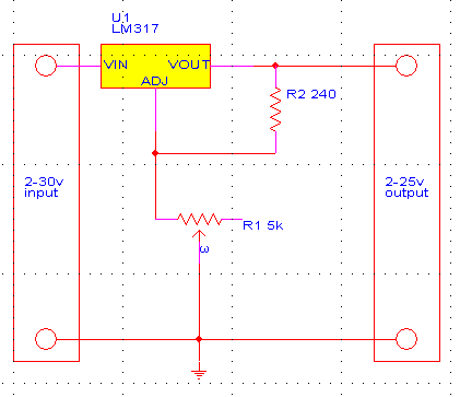

I've got a couple 9v wall adaptors that don't appear to be regulated. Would a circuilt like the one I've sketched below work to get a regulated output of 5v if I replace R2 with something like a 740ohm fixed resistor?

Well, a 9v wall-wart would give generally 9v. There used to be a decent page that described them and why you got really high voltages with no load, and such, but I can't find it now.
Anyway, if you specificly want 5v, you would be better off getting a fixed regulator like a 7805, rather than the adjustable regulator in the diagram. The there would be no need for the resistors.
EDIT: also, check the datasheets as these regulators usually require decoupling capacitors before and after them.
well, do the math as given by the 317 datasheet. ditto on the 7805 and caps comments.
note that unregulated wall warts generally will produce the rated voltage at the rated current. This means that the unloaded voltage will be well above the rated voltage. Though there is some wishful thinking on the ratings.

You are using a 240 ohm resistor that is used with a higher cost LM117. It has a lower operating current than an LM317. An LM317 with the 240 ohm resistor could have its output voltage rise when the circuit doesn't have a heavy load. Use a 120 ohm resistor instead with an LM317.

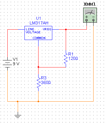

Finally got my EWB cd's...
Using the 120, 360 would be the compliment for 5v right? Thanks again!
The LM317 with the H suffix is in a small TO-39 case and will overheat and shutdown if its dissipation exceeds about 700mW. Therefore if your power adapter has an output voltage of 11V then the LM317H overheats with only 117mA of load current.

Audioguru >> The demo circuit has the AH package, but the part I was looking at Digikey was the "LM317TFS-ND". Unfortunately EWB didn't have anything that seemed similar to that part.
Hero999 >> The plan is to use most of them in color-cycling LED nightlights that can plug in using a wall adaptor. The reason I was wanting to go with the variable was that some of the light setups vary in the # of LED's, while still allowing the possiblity to use them in simple 5v low-power circuits. Just seemed silly not to order 25 with the price break.
Does the LM317TFS-ND from Digikey seem like the appropriate regulator for this type of use and flexibility?
Thanks again!!!
The LM317TFS-ND is fine. If it gets hot then you can bolt a heatsink to it.
Your last schematic is fine.
