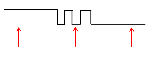

To avoid switch bounce, I recommend scanning the key switches at a very slow sampling rate from 10-40 times per second. The slower the better but not too slow so that the buttons appear to be sluggish. A person will not perceive a 50msec delay in response from the buttons.

The READ_KEYPORT routine is called every 256usec from the main program loop which polls the TIMER0 for overflow. Since this is too fast for key scanning, the KEY_TIMER further scales this down to 65msec.
The routine looks for the falling edge and sets the corresponding bit in KEYEDGE. This allows simultaneous scanning of 8 switches.
Below, illustrates how the routine filters out key bounce. The scanning rate is slower than the frequency of bounce and checks the switches after the key switch has stopped bouncing.
