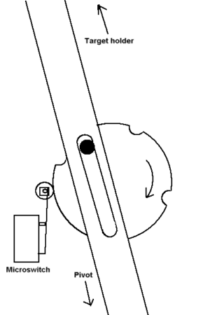

I'm sure we could come up with a way of reversing, but do you really need to? I had in mind a driven disc with an eccentric pin riding in the slot of a slotted arm supporting the target, so that with each successive 90 degree disc rotation in the same direction the pin moves the arm successively to left, middle, right, middle, left, middle..... positions. They say a pic is worth a thousand words, so bear with me and I'll post a pic in due course.

Hello again Alec,
I've just taken a look at your pic. I see what you are saying now. I will break out the paper and card and start a mock up but I fear the centre aiming mark will still be the problem, I can see the 4 marks in the corners being simple but the movement to get to the centre eludes me.
I shall have a crack at it this weekend.
Thanks,
Bing
I should have explained: that pic relates to one degree of movement only (L/R). I envisaged mounting that set-up (A) on a lever (or sliding shaft) moved up/down by a similar set-up (B) providing a second degree of movement. So if we assume we start at the bottom left target position, then one step up using A and one step right using B takes us to the centre target. Etc.
It occurs to me a single uni-directional geared motor can be used to give all 5 target positions. A driven shaft carries an indexing disc as before, but this time with 5 notches, and also carries two cams as per the attached; one for controlling vertical movement and the other for horizontal movement. Respective cam followers are coupled to linkage (pivoted arms, parallelogram linkage or whatever) for the V and H movement.
