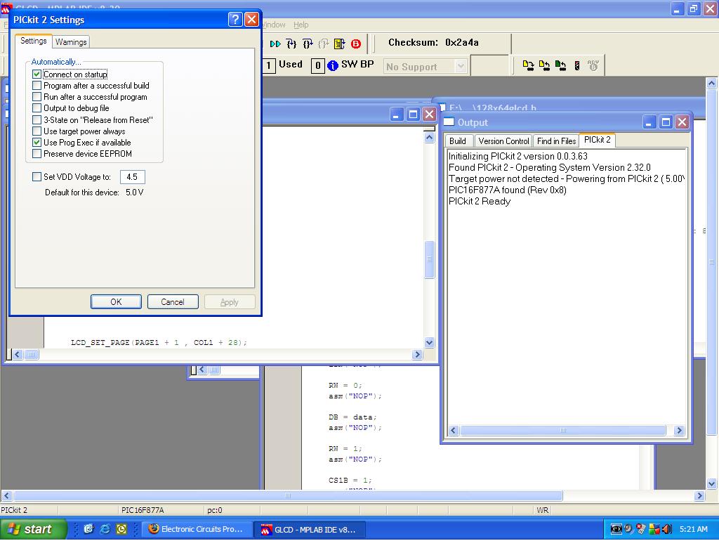

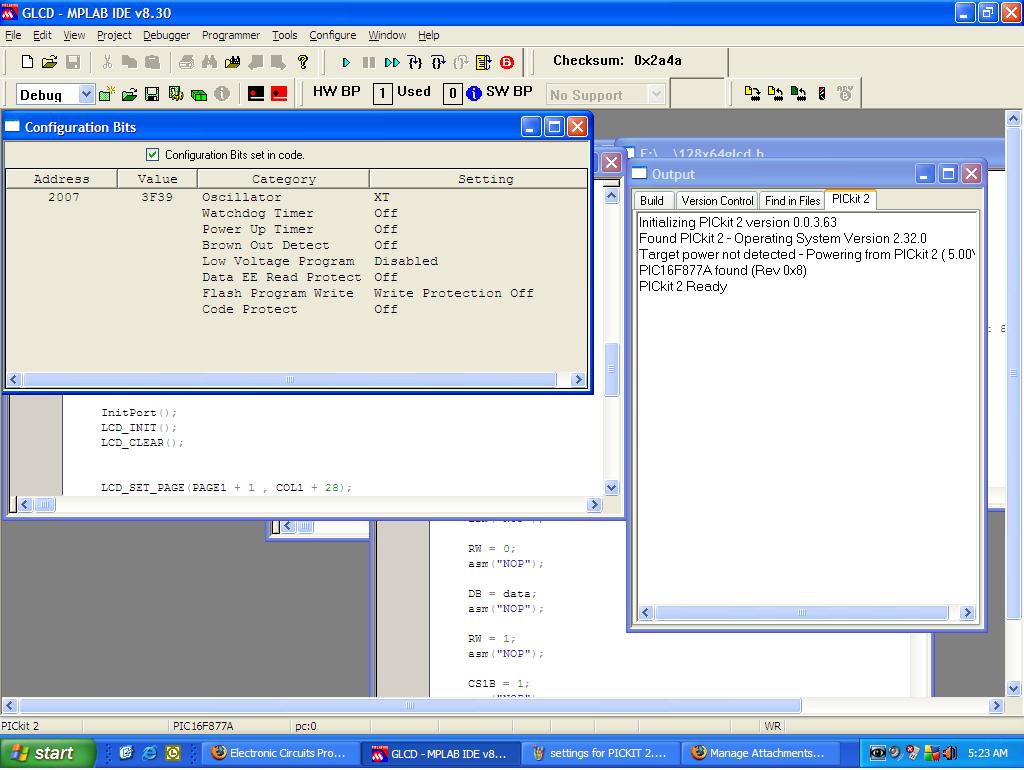

PICKIT2 as a programmer works fine but when i try it as a debugger, its giving me error.
I have attached the settings for PICKIT2 as well.
kindly check and suggest some possible solution and the ground pins are properly connected. i just checked it.

Do you have an actual config line in your code. The window you posted above is not used and you need a line such as,
#pragma DATA _CONFIG, _CP_OFF & _PWRTE_OFF & _WDT_OFF & _HS_OSC & _LVP_OFF
in your source file. Or, untick the box in the window posted above.
I have used the same config Pommie. Its still not working. I tried with the stand alone software too. Even there the problem seems to be same.

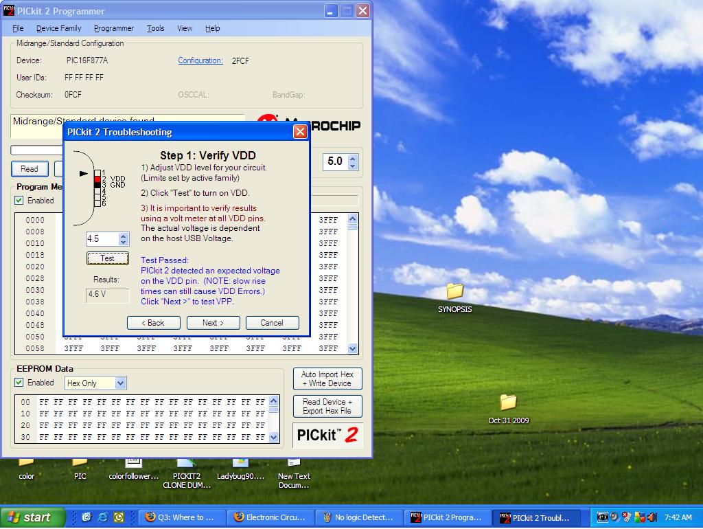

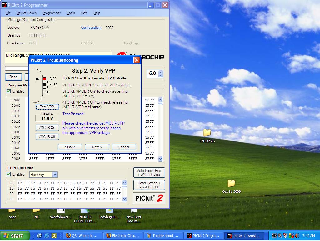

Have you seen the Pickit2 user guide page 57 for all the possible causes of Error 28 ? - there is a lot to go at.
Just looking at your screenshots, the thing that stands out is the Debugger Settings Pk2 window - attached is the version I use.
Think it might be that after building you are trying to enter debugger but it has not been programmed by debugger.
Worth a try...
