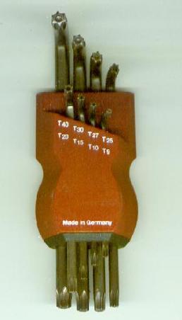

Tamper-proof hardware is easier than a label. Security Torx bits are the best. It is time wasted if you attempt to drill a center hole in a small Torx bit without breaking the drillbit or Torx driver.
What do you mean by a label?
I agree, you can buy these sets everywhere. :D
