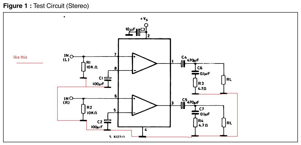

As my first electronics project, I am trying to build a small audio amplifier using the "TDA 2822M" ic.
I am using this stereo schematic from the datasheet:
My question is: where should I connect the negative voltage?
Thanks in advance for any help!
I've drawn in all the connections you need to make....see the sketch..
yes.... it's a single supply amp, not a dual supply amp...... at least that's what i thought he was asking......
