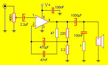

I think this is a rather simple question.
I want to make an audio amplifier using a pair of TDA2003, but in stereo. I plan to use a 1A AC transformer that i built in school as the power supply, its output gives either 11+11v or 15+15v.
I looked for info on the web but found nothing on this subject. Any help will be appreciated.
This is the TDA2003 mono schematic.

Hi Riff Raff,
welcome to the forum, too.
You might choose either 2X11V or 2X15V for the supply transformer. Using 2X15V the rectified and smoothened DC must not exceed 18V. (1A is a bit low, but might suffice for room volume settings - repetitive peak current is 3.5A)
Please refer to the ST TDA2003 datasheet. Your schematic omits an extra 100µF electrolytic capacitor for supply bypass. This is extremely important to avoid oscillations of the amplifier and resultant overheating.
Also planning the circuit layout please follow the exact trace routing as given in the data sheet (page 6/10) to avoid any complications concerning oscillations.
And, of course (as already pointed out by Torben) for a stereo amplifier you must have two identical boards.
Special care must be taken of the output electronic capacitor (pin4 to speaker). It must be able to stand peaks up to 40V. Even supplied with 12V the peaks will exceed 25V in any case.
Driving the TDA2003 at it's maximum performance you should plan for a good heat sink (e.g. SK104) and good ventilation as well.

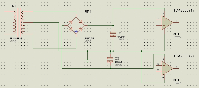

So, how do i connect the supply?
the first TDA2003 should be connected between the "most positive terminal" (don't know how to say that in english) and the ground, and the second to the most negative and the ground ?
In other words, something like this?
Your TDA2003 on the bottom will blow up because its supply is connected with backwards polarity.
Your supply is plus and minus 11V but the TDA2003 schematic uses only a positive supply, not a negative supply. If your supply is plus and minus 5.5V then it cannot be used.
With only 11V for its AC supply, its DC is 13.5V at full output and output power at clipping into an 8 ohm speaker is only 2W. With a 4 ohm speaker its output power at clipping is only 3.5W.
If you have two 4 ohm speakers then the max continuous power supply power is 3.5W x 4= 14W. The max continuous power supply current is 14W/13.5V= 1.04A.

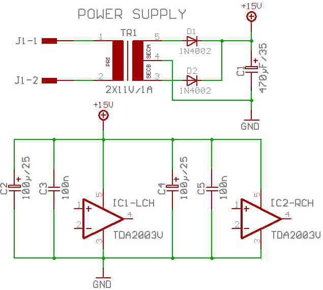

This simple power supply will meet your requirements. It is a full wave rectifier with the ground connected to the center tap of the transformer.
Instead of using 1N4002 you might refer to 1N4001.
Connect C3 and C5 directly to the IC pins, and also once again, refer to the data sheet PCB layout.

Hi Hans,
Shouldn't there be a junction where the net from pin 3 on IC1-LCH crosses the lowermost net?
Regards,
Torben

Hi Torben,
very quick look! ;)
Of course, there must a junction. Just happened in a rush. Nobody is perfect. :D
(Not even German combat pilots :p)

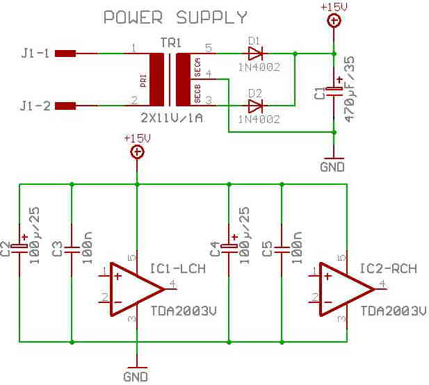

Correction
