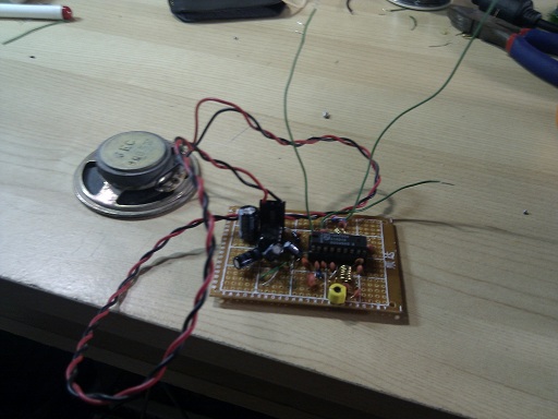

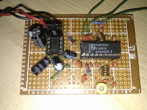

I am building the TDA7000 FM radio using the schematics from this website TDA7000 FM Radio Receiver Circuit
I added a LM386 amplifier to power a 8 ohm speaker. I use a trimmer capacitor 2-35pF.
I build it on a perfboard and have tried to keep the connections as short as possible. All capacitors are ceramic. I have most of the capacitor values, except for C1 where I used 0.1uF, C10 - 160pF, and C12 - 56pF.
Upon first power on (and until now), all I can hear is white noise on the speaker. The white noise is stable with MUTE switch ON, e.g. artificially generated by the TDA7000 chip. With the MUTE switch OFF, the white noise remains but seems to vary slightly when I touch various parts of the board. However, I am unable to tune into any FM stations despite tuning the entire range of VC1 and trying various inductor sizes.
Any ideas how I can debug the circuit, other than keeping on checking connections and hope to find something wrongly connected? I have a 100Mhz oscilloscope, though I know it's probably useless at FM frequency. Any expected waveforms/voltages at various pins of the TDA7000?
Is there a way to know which FM frequency the circuit is trying to receive?
Also, regarding the antenna, what is the purpose of the seemingly complicated capacitor/resistor connections at pin 13, 14? The Philips datasheet simply suggests a capacitor to ground at pin 14, and another capacitor to the antenna at pin 13.
The photos of my circuit are attached. Any help is appreciated. Thanks.

FM is 88MHz to 108MHz here. I believe it's similar in Singapore so your 100MHz scope should be able to see something. (Make sure you use a 10:1 probe).
The antenna circuit is to tune the antenna to the RF frequency. What antenna do you have connected?
Did you carefully wind the coil L1 to the specified dimensions? That value affects the tuning range of you circuit.
The IF frequency is 70kHz, so the local oscillator frequency at pins 5 and 6 will be 70kHz below the RF frequency it is trying to receive.
The data sheet and the example on your referenced website both use a PCB with a ground plane. Without a ground plane the performance of the circuit is problematic. 100MHz circuits really need a ground plane for proper operation. A PCB is best but you probably could get by with building it on a perfboard that has a ground plane.

Hi all,
Thanks for your replies. I am well aware of the limitations of the TDA7000 FM receiver chip. This is just meant to be an experimentation for fun for myself, and not part of any project/assignment or things like that. As long as I can get some audible sounds from a true FM radio station coming from the speaker, I am happy that I have built something that works. The intention was never to build a sophisticated FM radio.
@crutschow: thanks for your answers. I am using a 1m antenna as indicated in the reference website. I also tried various antenna sizes.
I will use my oscilloscope and try to find the oscillator frequency. Is there a way for me to measure the inductor value using an oscilloscope?
I add one more turn to the inductor and got the circuit to to play many local FM stations satisfactorily without much change in the circuit. I am using a 1m antenna. The MUTE switch needs to be disabled during tuning and a plastic screwdriver needs to be used, otherwise the frequency will change once the screw driver is removed.
I knew the circuit started to work when I heard a distorted speaking sound from the speaker. I squeezed/stretched the inductor and change the trimmer until the sound becomes clearer. By experimenting eventually I could tune the entire FM band using the trimmer cap.
Without a proper pcb or a perfboard with a ground plane, the circuit is very sensitive. Touching the board or moving my hands close to it could change the frequency significantly.
Hope this helps others who are trying to build the same circuit.
I would say comparatively nice construction..:)

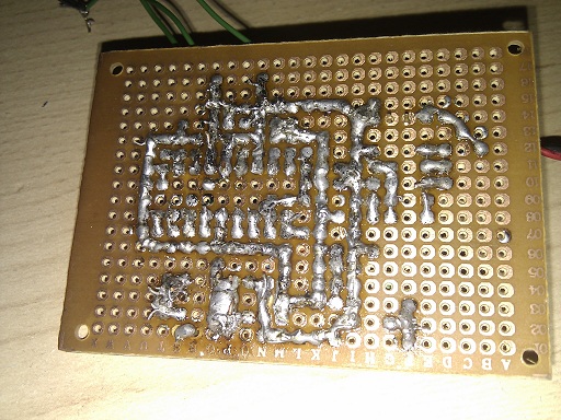

But there's some excessive solder applied I think, that you should take care off in the next build..
Without a volume control may add noticeable distortion at full punch..
Built-in white noise of LM386 will add some horror along with that, result is terrible audio performance from the little speaker..
Better amps like TDA7052, TA7368P, CXA1522, volume control, a bigger full-range speaker would be nice improvements and may add noticeable difference in performance with the same radio-chip.
As a beginner radio maker, I think you've done it well.

Hi transistor495, thanks for the encouraging words. :) Although I have built several FM transmitters, this is my first FM receiver, and I am happy just to see it work. The excessive soldering is due to the repeated replacements of various components to see if it makes a different (especially near the oscillator section). The speaker is from a junk computer (you can see the connector socket) and you are right that the audio is distorted when the volume is very loud. When my time allows, I will redo the circuit on a proper home made PCB with another amplifier chip (I do have a CXA1522 in my junk box) and see if any improvements can be made.
