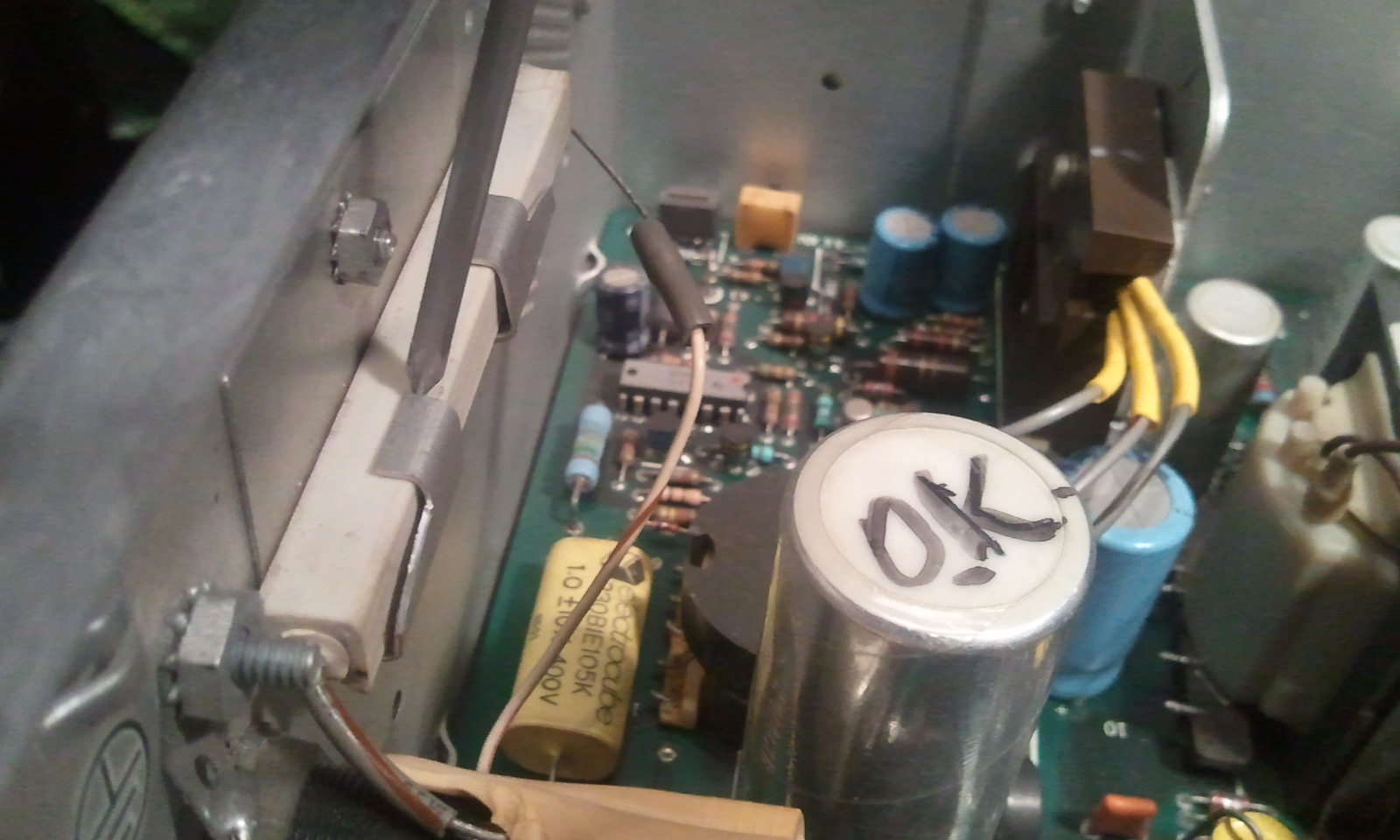

Hi All,
My oscilloscope Tektronix 2235 runs Ok but i have this issue: after 2 hours i check with digital termometer ( like auto RC 2 stroke engines ) the temperature of power supply area, lateral housing, and i mesured 50 degree celsius in the first 20 min and 71 degree after 2 hours, the main housing was very hot and overheating smell is present.... I see this power supply don't have cooler system maybe i should try to assembly one for good cooling capacity. Please tell me if you have the same operation mode and problems.
Sorry for my bad English
Best regard's Mike
Uncover and emove the switching power supply perforated top cover and keep it naked; turn it on for a while; unplug from the wall and finger check/thermometer check what component is the one overheating/smelling.
That oscilloscope should run cool without need for fans.
Thank's for advice, i found the source of problems..... someone put serial rezistance in 220 V ~ 270 ohm value ( i have 50 V aprox. voltage drop for this reason ) please see pictures. I do not know the reason for this, maybe it was afraid to burnt this nice SMPS. Now i will buy this oscilloscope 100 euro, i think this price is ok for 29 years old scope isn't it?
Best regard's Mike
Never seen that resistor that looks factory installed in 120VAC oscilloscopes; perhaps is needed for 230VAC operation. Its presence explains the extra heat dissipated. Check if the schematic diagram shows it.
I would not remove it.
Hi, i remove the rezistor and every think is OK, my oscilloscope runs without any problems for 6 hour's. This SMPS is from 70 to 250 AC volts, don't need resistive divider for 230 AC operated.
Now i'm happy, operational temperature was only 35-40 celsius.
100 euro is the best price, i will buy.
