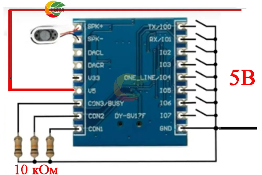

I'd suggest such as an SV-DY17F module; tiny and very cheap, with storage for audio files up to around 4MB total.
The have both a speaker out and stereo line outputs.
(Or somewhere around a pound / dollar from Aliexpress).
As shown in this diagram, each switch would trigger a different file to play, 00001 - 00008.mp3
You would only switches for the number of different files you wanted to use, plus a power switch.

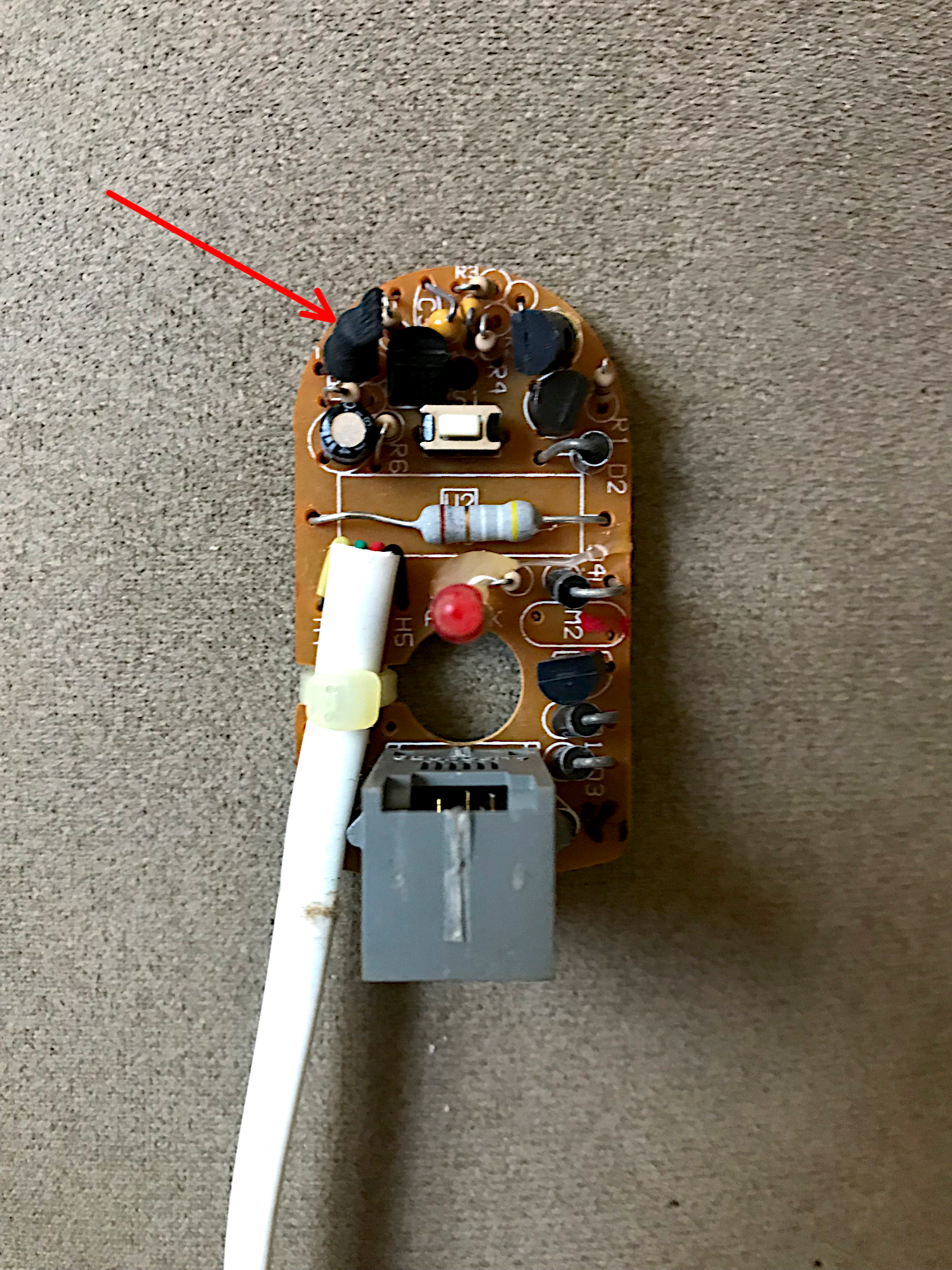

Old School telemarketer zapper. I got this back in the late 90's. I think I bought it at a hardware store when I was looking to buy some longer telephone line for my pre-cell phone era landline phone.
You plug the incoming telephone line from the wall to the zapper, then plug the other end to your phone. After you answer, if it's a telemarketer, you press the little button and the red LED light comes on and it plays a digital recording "Boop.. Boop, I'm sorry, this number does not accept these type of calls. Please regard this as notice to take this number off your list" , then repeats one more time then automatically hangs up on the caller. It worked well. At a certain point I hardly ever got any telemarketer calls anymore.
If that was battery powered and had a lightning cord end on it that would be premium. If someone would come up with a little device like that to connect to cell phones they could probably make a million dollars off of it. I doubt there's anyway I could convert this one to a lightning cord connection.
And it runs off landline phone voltage:
Here's the zapper board. I can't see anything on there that recognizable to me as a memory chip. The only odd thing I see that might be the memory is the thing with the red arrow pointed to it.

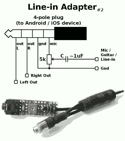

A normal stereo 3.5mm (TRS jack) cable will be connecting the audio OUT on the MP3 player to the audio OUT on the iphone adapter.
A TRS plug shorts the external mic in to ground.
You need to connect the audio source to the appropriate points on a TRRS plug, like this; you can ignore the headphone outputs if you don't need to hear the incoming audio:
Or, use a PC headset adapter cable - that splits out the four contact TRRS plug to two separate TRS plugs, one for headphones and one for mic. The audio would go to the tip and body (gnd) of a TRS plug.

Hey I found this.
This looks like what I'm looking for. It's a mic line in 3.5mm 4 conductor TRRS Male to 3.5mm TRS Microphone Input Jack with built-in Attenuator. Do you think that will work with the white iPhone lightning adapter that I already have? Or do you think the iPhone needs to detect a "headset" type setup with headphones and a mic since it's a headset that might be "allowed" to be used on a phone call on an iphone. The iPhone might detect just a line in only setup like the Amazon one for like recording only and not for phone calls.
That should work for mic in audio, but I don't know if you would be able to hear the incoming audio??
If may "see" the headphone contacts as open circuit (no connection) & still use the phone speaker, but I'm not sure on that...
I suspect that's more for use with audio recording apps?
Yeah, I think the iPhone needs to detect specifically a headset (line-in + line-out) to allow input audio on a live phone call. Which is what I'm looking for.
Have you got a picture of the other side of the board?, there's perhaps a SM (or COB) chip on that side. The device pointed at by the arrow appears to be an opto-coupler, hence the heatshrink crimped round it.
