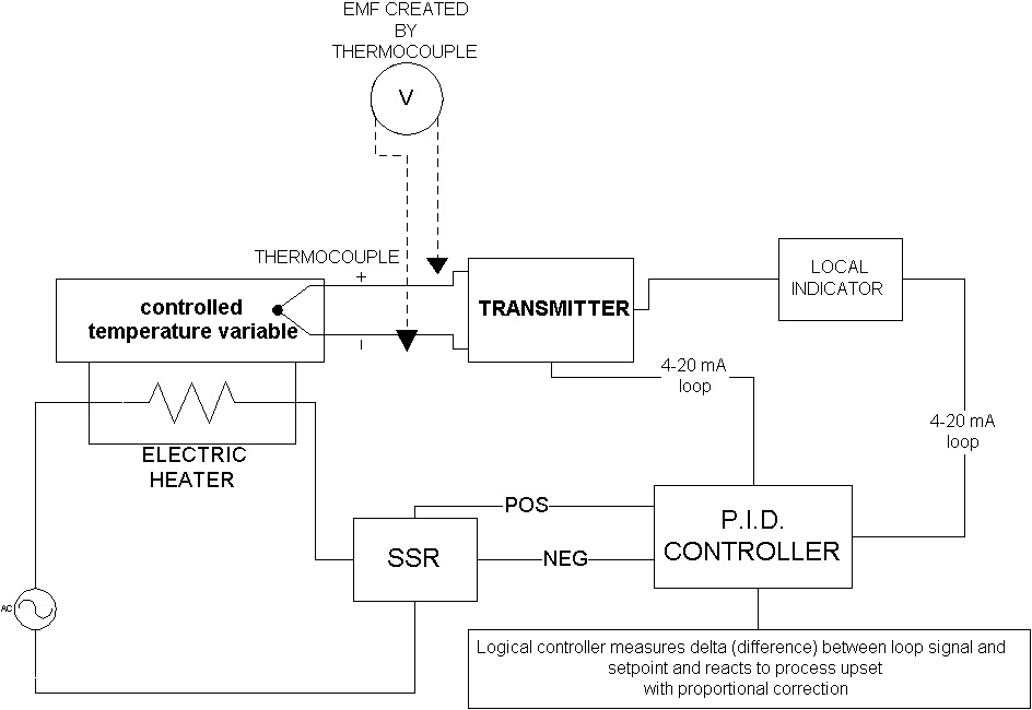

I thought the forum might benefit from a block diagram of a PID control loop using a 4-20mA signal.
I must remind everyone that this technique is used when devices are located significant distances from each other in an industrial setting. Thus, a transmitter is needed to relay the signal measured locally to a distant device, or several devices including indicators. Usually, in practical applications the controlling element is actually a control valve with a pneumatic actuator, but many types of devices can act as a controlling element including solenoids,pumps, motors, etc. In some of these cases an off/on digital type control might be more suitable than PID control. It depends on the requirements of the proccess.
