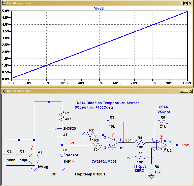

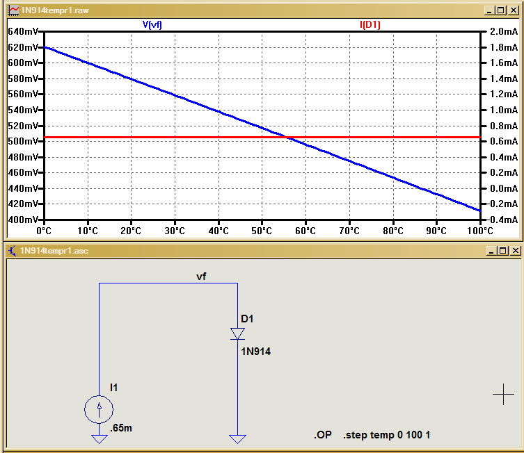

Basically what I think I need to do is to have a current running through the diode (stable current) , and then measure the voltage over the diode.
Then I will use a differential amplifier to measure the voltage over the diode and amplify it into something usefull.
Is this how to do it?
Can anyone help me figure out what the voltage over the diode will be at a certain degree? It should be liniar if I have a constant current.
Thanks in advance

The diode forward voltage drop is about -2mV/Cdeg, look at this simulation for a typical plot.

Si diodes as sensors.
Many years ago I did extensive testing of a bunch of about 20 diodes for temperatures from 0º to 100º. Data was recorded manually in a painfully slow process which I tried to make as precise (!) as posible. Diodes fed with constant current sources.
While I do not doubt that it was imprecise for any reasonable standard I concluded that:
* Voltage versus temperature curve was NOT linear between 0º and 100º.
* The curve varied sensibly from diode to diode (they were supposed to be from the same batch) (??).
* The curve had the widest separation from the straight line (0º to 100º) at 26º or maybe 60º... actual details escape to me because my precious notebook was lost in a port abroad. Cannot say why I took it ashore. :mad: Learnt to never bring anything out of my bench again.
All this to say: you will have to calibrate each diode/s you will use.
When I was about to use them in a real design, I run across the LM335 which was MUCH easier to calibrate (you do it once). Maybe you would like to read about it here **broken link removed**
Browse for Politemp 832 under Circuits.

Your empirical results testing diodes for linearity highlights the very shortcomings of trying to use them for a reference; the lack of linearity and repeatability even from die of the same lot. Add to that the delta induced from self-heating across a temperature band vs. ambient and one finds the need for calibration for each unit as you discovered. When devices appeared back in the early '70's exploiting the band gap potential of silicon, a whole new horizon appeared for both accuracy and an array of new devices, which led to much more; think time standards and all that implies.

hi Agustín Tomás,
Its important to consider that many OP's asking for silicon diode temperature sensors are not requiring to measure temperature over a wide range.
Most are for controlling a fan or heater ON/OFF, so the full calibration is not required, only at the On/Off set point temperatures.
One member is using this type of temperature control for the roof solar heated panels and his swimming pool, been working ok for over 2 years.
If you hold the constant current less than 100uA [ some go as low as 10uA] then the self heating is not a problem.:)

Regarding the calibration issue, I'd like to know if it is possible if the non-linear output (of the temperature sensors using those diodes) be fed through a electronic network (RLC-op-amp, etc) simulating a transfer function to process and linearize the output? I suppose that's how the circuit like the one designed by **broken link removed** is produced?
hi Viz,
Yes its possible to produce a close fit using short 'chords' to most non linear functions.
Can you elaborate on that, sir Eric? I was imagining that the designs which linearize the output of circuits like these utilize laplace/fourier/Z transforms in s/z domain and it would be matched with another transfer function to act on the linearization, where some transistor-resistor-capacitor-op-amp networks may produce. Am I correct?
hi Viz,
I will try to produce a graphical example to answer your query, post tomorrow if I can...
