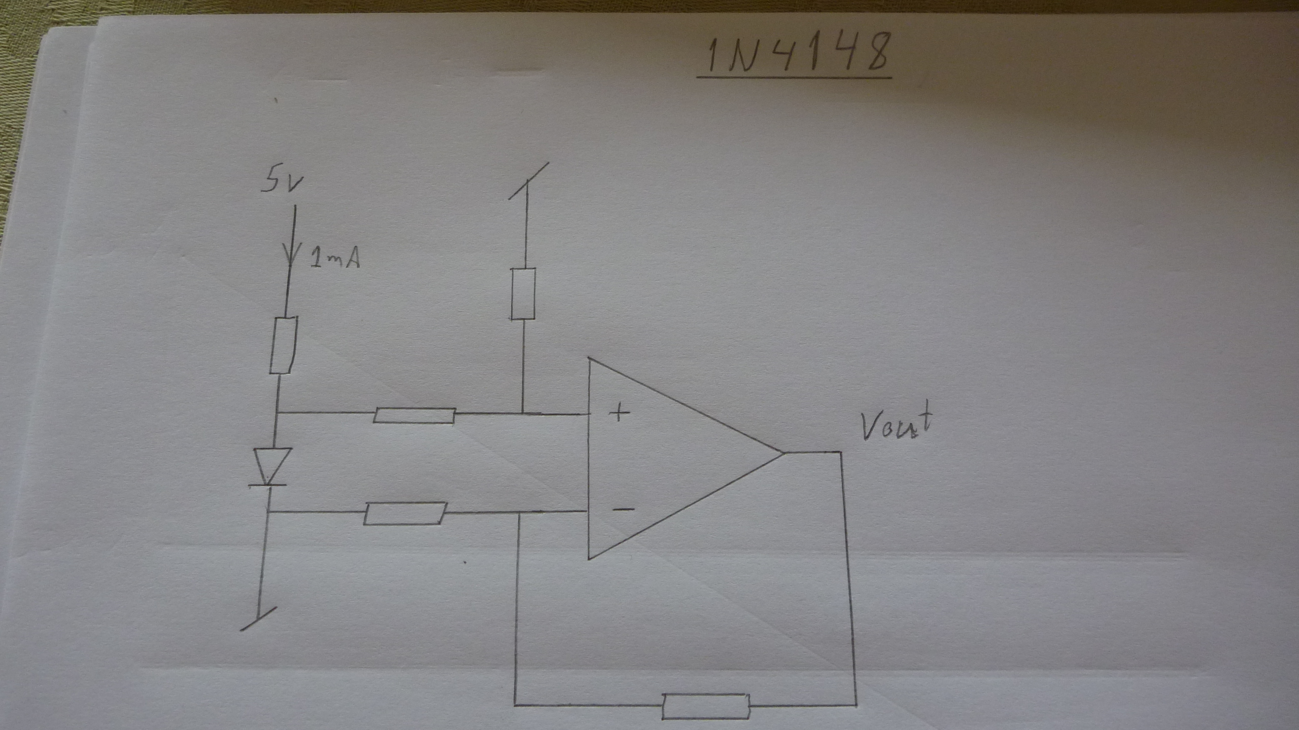

temp measure with diode 1N4148 and differential amplifier

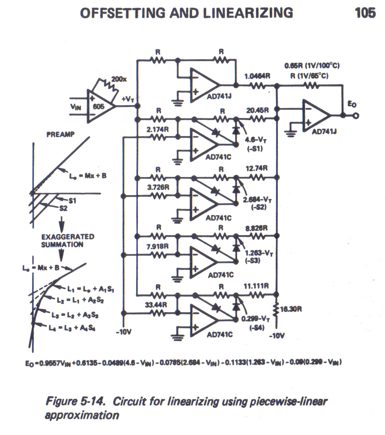

Found one of my reference books, this is a PWL [piece wise] approximation.

Convenience of using it nowadays?
A (very) cheap sensor followed by a costly linearization circuit.
With so many linear sensors available, the LM335 among them, what could be the reason to use that approach? I cannot see the advantage.
The advantage is to learn :D it awesome and I want to build that thing that can liniarize a bowed line with electronic parts. Try to imagine what else I could liniarize xD like everything

I see. Looks like an employment of numerical methods.. :eek: Thank you very much Eric.
A (very) cheap sensor followed by a costly linearization circuit.With so many linear sensors available, the LM335 among them, what could be the reason to use that approach? I cannot see the advantage.
the cost is not that much by the way, I calculated the cost of all the components and it came around to RM5.00 or approx eqv to USD 1.50. That is if we use exact-valued resistors according to the diagram. The power consumption is another thing... perhaps two MCP62414 quad op-amps might serve the purpose (50uA supply current). So if you're still using the network then it would still be very useful.
double sided PCB+surface mount parts will further put this one down to just as big as a dollar coin. :D
The diode is wired as shown in my post #4, the post also shows the result.????
One member is using this type of temperature control for the roof solar heated panels and his swimming pool, been working ok for over 2 years.
Yip, and that member would be me. Eric helped me with the circuit.
As reference, I also added a PT100 sensor right next to the 1N4148, and calibrated both sensors for 0 .. 100°C.
I’m amazed at how accurate the Si diode is. Yes, I admit, it’s not 100% linear, (at worst about 2°C out) but for my application it works like a charm.
Have a look at this post (https://www.electro-tech-online.com/threads/pic16f88-freezing-in-operation.39061/) for the circuit and code.
