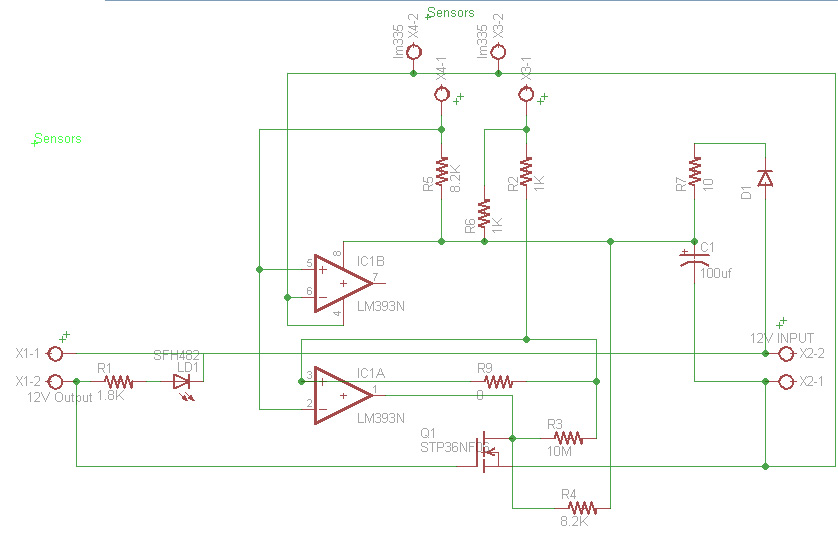

i'm a begginer in electronics and i will really appreciate some help.
i'm trying to build a temperature controller (analog cause i dont have enough money for all the digital equipment and i lack the experience) that controls a aquarium substrate heater(heater cable aka HC) and a water heater.
the theory is this:
i have 3 sensor: 1 for the substrate, 2 for the water just above the substrate and 3 for the water column.
i want to measure and compare 1 and 2. the HC must operate as long as there is a difference in temperature between 1 and 2(2 beeing smaller than 1, if 2 = 1 then the HC stops).
if the water temperature drops below a set value(26 degrees celsius ) than the water column heater starts.
i would like to see the temperature(i will think about this) and an on/off HC LED.
please help. tons of beer for anybody who helps if you ever come to Romania.

Use a thermistor and a resistor to make a voltage divider and connect that to a comparator, use a zener diode to set the reference voltage on the comparator, this unit will need some calibration of the thermistor and the resistor to land on a specific temperature. Use this circuit to drive a relay to control the heater.
@MOSFET KILLER - can you help me out a bit more??? something like a schematic or at least the parts. my only experience with electronic is a small stereo amp a few years ago so what you told me helps a lot but not enough to get started :D

Perhaps a LM3914 dot/bar graph could be used to display the temp?

This is a start, this is my differential thermostat i use for my solar hot water heater. You will have to add a 120v/12v transformer to power the circuit, then add relays accordingly. Also you'll have to isolate the sensors maybe with glass straws and silicon. Or maybe this won't help at all but here it is.

ok this is getting a bit offtopic. it dosent matter if people accept that the substrate heater is a good thing or a bad thing. i love electronics and aquariums so i'm trying to do a little of both.
i'm not trying to even out the temp in the tank. only heat the substrate a little so convection occurs. a heater cable is underpowered. it only heats the water around it which tends to rise which is replaced by colder more oxigenated water above and so on. that will eventually heat the substrate up a bit. when that happens i want the HC to be turned off so the substrate cools down. i may not fully understand how a substrate heater works or what a controller actually does but i'm thinking my ideea would work.
i really dont care what Tom Barr / Dianna Walstead thinks. they have great experience and beautifull tanks but how long do they keep them? enough to take a picture of them(i'm not sure and this is irelevant also). i have proof that it works so i wanna try it.
richard.c has a great plan for a controller and i'm gonna give that a try. i'm pretty sure this is an electronics forum so let all stick to that ;) (no offence to anybody)

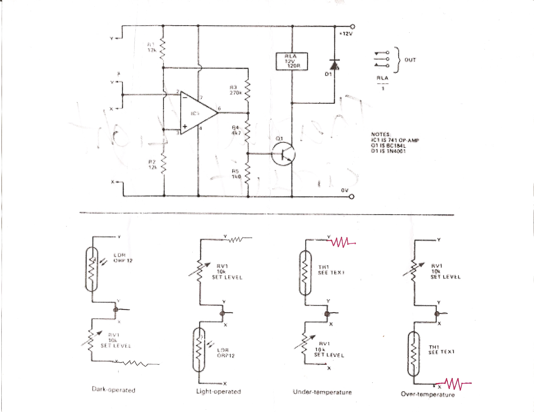

hi every body i am new memeber my name is hoooo i am looking for temperature alarm sensor circuit(rang 0c-100c) this is my final year project help ...
thanks cbiblis but i cant get the kty10 sensor in the market at my place do you know it other sensor can subtitute for it
Here is one of my favorite circuits, the parts can be picked up at radio shack, except maybe the thermistor.
