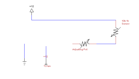

Hi there I am wanting to build I believe a fairly simple circuit. I want to put a probe in my computer that turns on a fan when it senses 40 degrees C and turns off when the temp drops below 40 C. Simple on or off I don't want it to be variable speed or anything.
I have some temperature probes from a temp display panel for my computer. The simple probes give temp info by resistance (obviously).
Temp probe give a resistance of about 10k at room temp
I want the circuit to turn on when it has a resistance of about 5.7K
I would also like to have a pot to adjust this voltage as well
I believe the 12 volt fan can draw about .5 amps, but probably best to assume .75 amps to be safe. If its easier I can just use a relay to handle the higher current.
I just started messing with Tiny CAD and I have attached what I have thus far, its not much..
I believe I could use a transistor to do this, but I have no idea on how to do the calculations for anything. Any help is much appreciated!
thank you very much,
Seth
