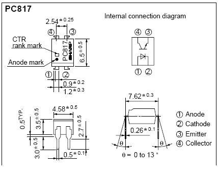

I need to test a PC817 but I don't quite understand the above procedure, can some EE please explain it so a noob like me could also understand it?
thanks

Dear Quaint and Greg,
I am surprised and sorry to see the posts in answer to your query regarding testing of optocouplers. None of the answers are clear or complete, in fact they are more confusing for a beginner! I will try to explain a simple procedure in simple English. The optocoupler (PC-817) has four pins, pins 1-2 are internally connected to an LED and pins 3-4 are connected to a NPN transistor. Take an analog multimeter, set it to the RX1 or RX10 ohms range and connect the black lead to the anode of the LED (pin 1) and red lead to the cathode (pin2) of the LED. The meter should register a low ohms reading, the exact value of the reading is not important, it should be low reading. Now just reverse the meter leads, there should be no reading on the meter, or it should show an open cicuit. Now for testing the transistor side, connect the black probe of the multimeter to the collector (pin 4) and red probe to the emitter (pin 3) keeping the meter range switch in the RX10 range. There should be no reading, or maybe a very slight movement of the pointer. Reverse the meter probes, and again there should be no reading. Reverse the probes once again. Connect a DC power source, say a 3V battery, in series with a 470 Ohm resistor, to pins 1 and 2 (positive to pin 1). The meter should immediately show a reading indicating a current flow through the transistor. On removal of the battery, the current should stop. Thats all there is to testing an optocoupler. Any deviation from the above readings indicates a faulty optocoupler.
chinmoy,
Thank you for taking the time to explain the above procedure which can help a lot of other beginners in the future too.
cheers
I have several analog meters and their polarity is not consistent. The important thing is that it reads low (half scale is OK) in one direction and open in the other direction.
All of my digital meters use the red lead for +, which is the opposite of the way indicated above. Use the "diode test" range if it has one. On most digital meters you should have a reading between 1200 (some meters 1.200) and 1999 (1.999) in the "forward" direction.
