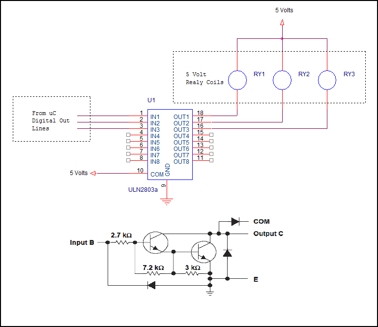

hi ron, my original post asked for a circuit to test uln2003 chips. i put together the circuit you so kindly provided. i tested the circuit with a known good uln 2300. i can get all the led's to flash except for the led's connected to pins 11 & 10. tried several different new chips with same result. need help figuring this out. thanks. pg
I happen to stumble upon this thread because of the title. :)
I remember the old thread. I put a circuit together as I recall using a 4017 to drive the ULN2003 chip. That is strange as pins 11 & 10 would be the pins 6 & 7 inputs. See the attached as I found some remnants of the circuit I suggested. Just peculiar the first inputs / outputs work and the last two don't work. If you have a meter depending on how you are clocking the 4017 you could see if the input pins are going high when they should?

hi ron, o.k. the problem turned out to be a wiring error i made. now all led,s attached to the uln flash. i read your info on the pc814. very interesing. how and why would this opto be used? thank you.
