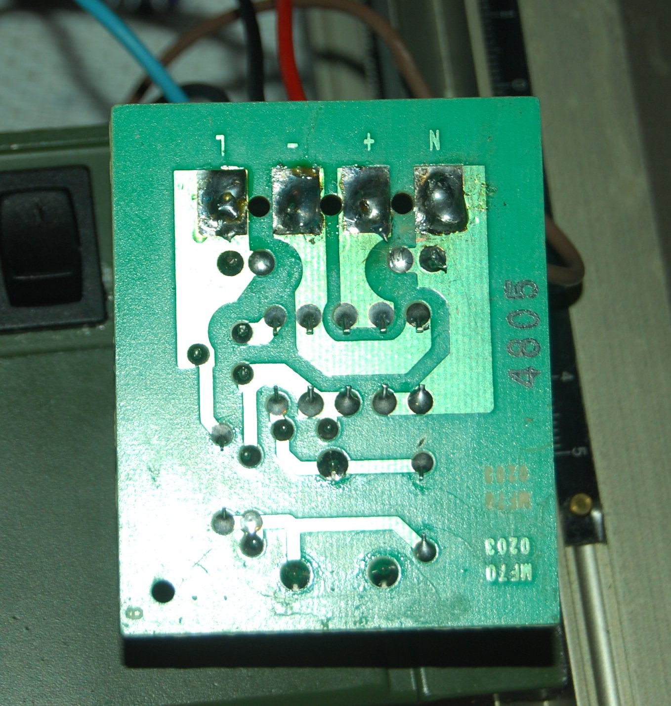

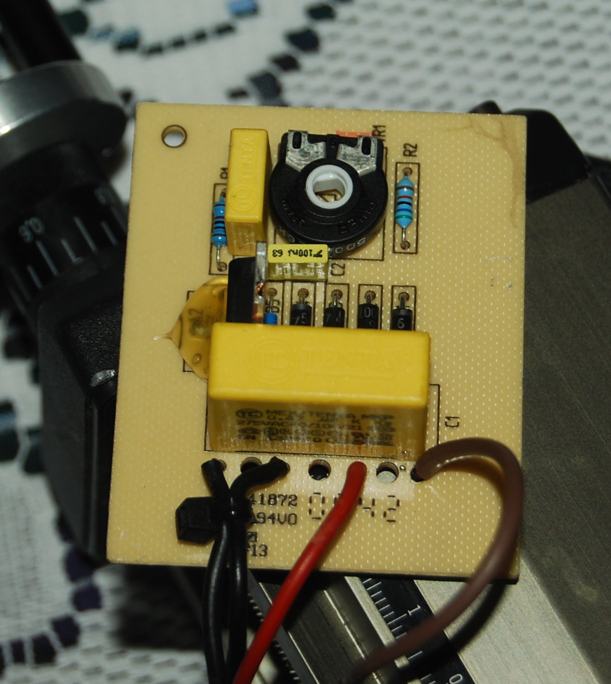

This my first post to the forum, to say i know nothing about electronics is to exagerate my understanding, so when my Proxxon Mill went bang and stopped working, my first thought was to hit it with a hammer, that always works doesn't it?
Sense prevailed and I have a multimeter and was hoping that there might be a logical step by step testing regime that even I might understand. I have attached 2 pics of the board, Ihope.
Any help will be much apprciated

Well the one component looks like it has a burn mark on the top of it, From here it looks like a transistor or voltage regulator, is there any part numbers on it?
we need to know what numbers are printed on the device which has obviously been damaged-at a guess it was either a triac or a thyristor maybe but we need the device numbers to be sure....you can set yr meter to read resistance and check for shorts on all pins on the damaged device also check each diode on the pcb for shorts too....but we do need the device part number before going any further

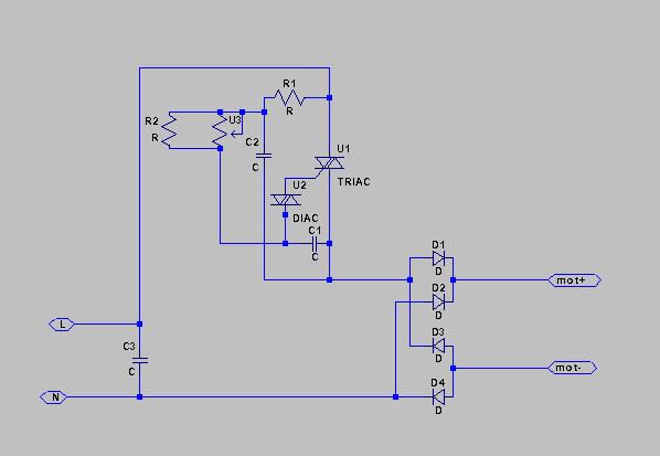

judging by a hasty schematic, the device is a Triac. basically it's a dimmer circuit feeding a bridge rectifier, which then feeds the motor.
looks like you got a metal shaving into the power supply box. most likely the triac is bad as well as the diac on the gate. the diodes in the bridge are only 1 amp diodes, this is a pretty small mill, isn't it?

I have tested the connections of the little cylinders on Ohms, R1 was 000, R2 was 229.9, D1 was 000, D2 was 000, D3 was 000, D4 was 000, D5 was 4.36. I hope this makes sense.
Also I have attached a drawing of the yellow side of the board, there sure is a lot of info on it. If you can't read it, I'll try again

ok the diodes are faulty if they are reading low resistance both ways-they need to be replaced (D1-D4)replace with 1N4007,D5 may be a diac-if it is sc it needs replacing also what are the markings on tr1???

There is nothing written on TR1 that I can find, it is plastic with a piece of metal attached to it, it has 3 legs although only one seems to soldered through on the other side. It seems to be stuck to the board with resin.
D1-D4 which are black all give a zero reading even when the leads switch ends. D5 which is blue gives 4.36 one way and 9.65 the other. R1 gives zero both ways and R2 gives 229 both ways.

D is for diode, and TR is for transistor, and a triac is generally speaking, a transistor (actually it's the equivalent of 3 or 4 transistors). the diodes showing 0 ohms are definitely shorted. replace them with 1N4007 diodes. the diode D5 should be tested out of circuit, and should under normal circumstances read open (infinity or "OL" on a digital meter). D5 is a diac, which is a diode that acts as an open circuit until a certain breakover voltage is reached, and at that point exhibits a "snap action" and acts as a very low resistance until the current is removed or reversed. the breakover voltage is usually somewhere around 30-60V, which you won't supply from a standard ohmmeter. the triac operates on the same principle as the diac, except it can be triggered by applying a current on the gate (also known as a trigger) pin. a diac and a triac are both bidirectional devices, while an SCR acts as a triggerable one-way rectifier. diacs, triacs, and SCRs can actually be made from regular transistors, but to get all of the breakover and triggering voltages correct takes a bit of work. it's a lot simpler and cheaper to just buy the replacement parts. if you want to understand the basics of how this circuit operates, you can read here:
if you substitute a bridge rectifier and DC motor as the load, you can see how this can control the speed of your milling machine motor.
