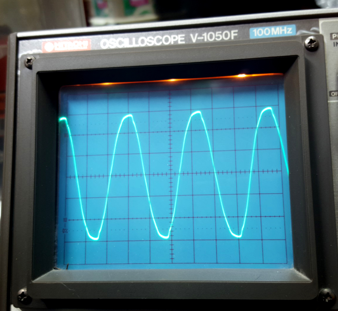

Finally got a decent SineWave thanks to ReloadRon and many of you kind enough and patient enough to guide me.
Thank you!
Probe Ground directly connected to Neutral
Probe Tip directly connected to Hot

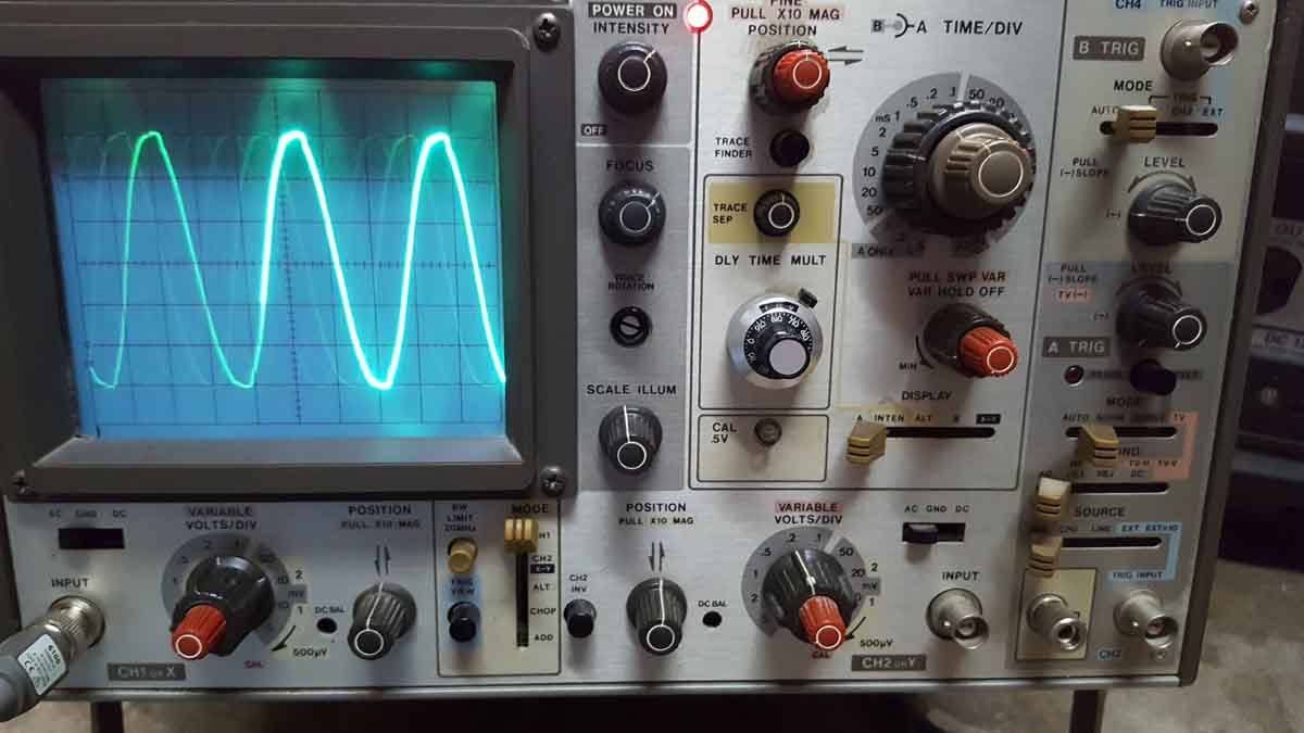

Here is the much better sine wave I finally got. The settings puzzle me a bit however....
VARIABLE Volts/Div setting at 2
TIME/DIV setting at 5ms
PROBE set at 10X
2V/div with a 1:1 probe. You have a 10:1 probe so it is 20V/div. Next is the red know turned to "cal". I think not.
You may want to make sure of that.
Also you want to make sure both your A and B Time/Div knobs are set the same as it looks like you have an intensified trace. The inner and outer knobs should be aligned so they are indexed together.
Ron

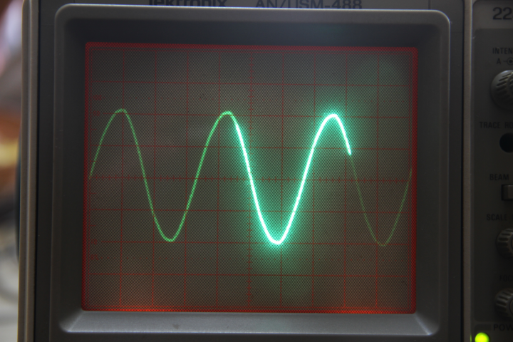

Are you sure that is not a camera shutter effect?
You can get some odd things when taking pictures of a CRT screen.

While I would not rule that out the thread starter has posted several images and if I see things correctly they all look to have an intensified portion of the sweep. With that in mind and how pronounced the intensified portion of the sweep looks I just tended to see it as a result of the A & B sweep speed settings. Purely a guess on my part. Also the A & B sweep time per division do not seem to be indexed the same. Beats me? :)
The selector switch below the TIME/DIV controls is clearly set to A,
so the OP is using just the A timebase which would be the correct thing to do.

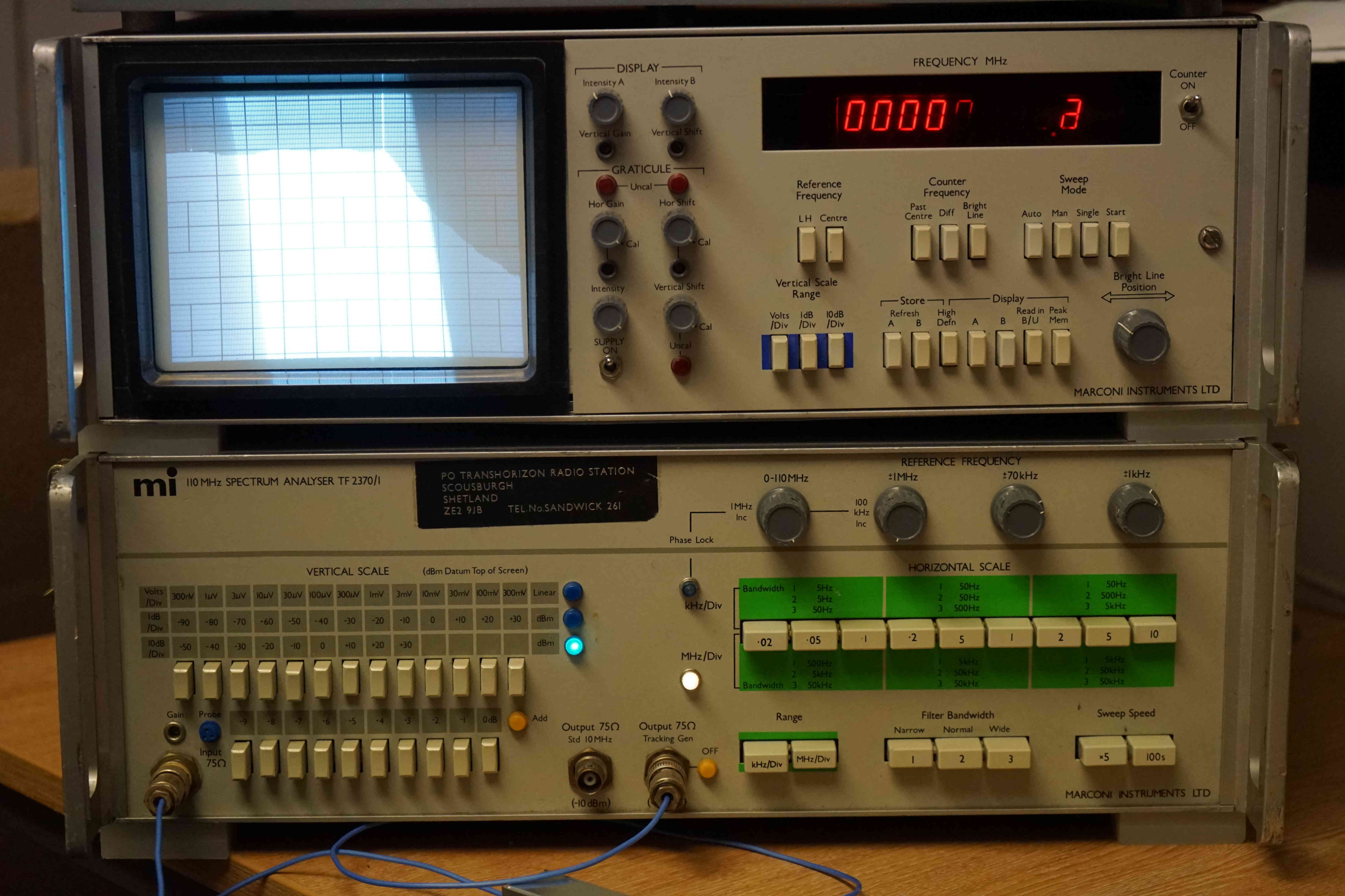

Look at this:
The multiplexed frequency display as well, yuk!

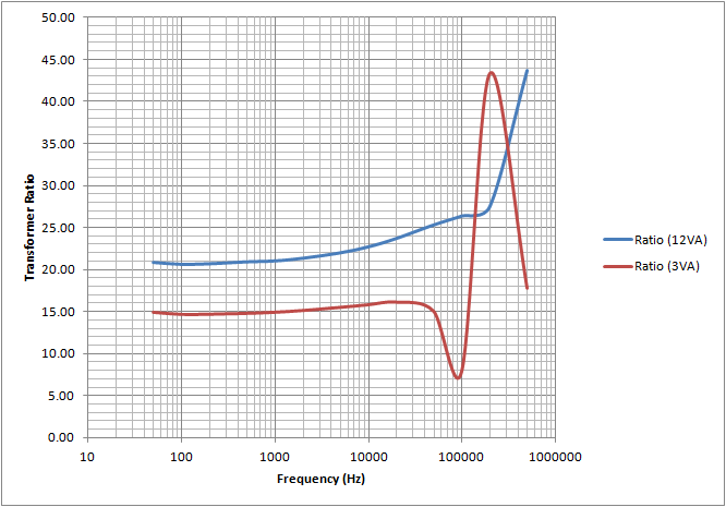

Earlier in this thread The Electrician did some tests to ascertain the usefulness of a "filament transformer" as a means of making isolated measurements of mains supply waveforms, with particular reference to harmonic distortion.
His tests are here:
His results were good, this lead to the conclusion that a simple mains transformer had a better frequency response than one may expect.
As a follow up to that, I did a few experiments on two transformers that I had in my "junk box".
One transformer was a 240v to 12v 3VA type, the other was a 240v to 9v 12VA type.
Both transformers are of the split bobbin type with the primary and secondary isolated from each other, rather than the secondary being wound over the primary as was usually the case with older transformers.
I used my function generator to inject 7.5v into the primary of each transformer, and used the oscilloscope to measure the voltages at the primary and secondary terminals of the transformer as I varied the frequency of the function generator.
I put the results into a spreadsheet and created a graph of the voltage transformation ratio of the two transformers.
The graph:
120292
Note that a higher transformation ratio indicates a lower voltage at the secondary of the transformer.
The 12VA transformer shows a reasonably flat response up to about 2kHz, the voltage then drops off slowly as the frequency is increase to 100kHz.
Above 200kHz the voltage drops off quire rapidly.
The smaller 3VA transformer has a reasonably flat response up to 40 to 50 kHz and then rises, falls and rises again as the frequency is raised to 500kHz, which was the limit of my test.
Further investigation showed that the 3VA transformer exhibited resonances at 120 kHz and 533kHz.

Good work. The blue 12VA transformer is easy to flatten out with simple RCs. I think the 100khz point can be brought back to flat. At 100 to 200khz I might give up and attenuate hard. I need to make one or two.

I have taken dozens of screen shots using my camera and never saw the effect of shutter speed. So today I decided to actually use camera settings other than Auto. Oh well and just plain wow.
The waveform is 60 Hz and I am not sure what my shutter speed was but apparently a lot faster than the 50 mSec it takes the beam (and then a little) to cross the CRT. I never would have thought the image would be so well defined. I shot subsequent images using slow shutter speeds but not so slow I needed to support the camera.
Ron
