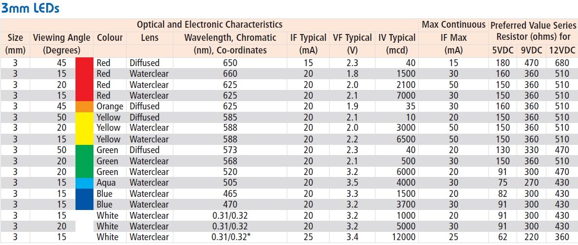

Thanks eric, but nowhere does it mention forward voltage or should I be able to deduce that from the specs I left (I'm a newbie)?
Dave
I may have worded my question poorly there. I know what the forward voltage of my LEDS is and none are lower than 1.5 V. So is the reverse voltage in the specs I listed above what is applied to the LED during diode tests since you mentioned 1.5V? Thanks for that image though I'll definately save that.

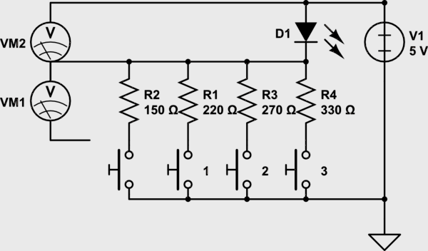

You can make a breadboard or box with dual row header and series R's and then measure the Vf forward drop to measure diode Voltage and VR drop to measure the current by calculating I=V/R for the same Vf measurement with only 1 resistor connected at a time or the LED in one position on the header socket at a time.
Since all LEDs are rated at -5V max, this may be safer than a 9V battery. Also only a few LEDs models are ESD protected so a static dissipative bench or 1M wrist strap ought to be used.
