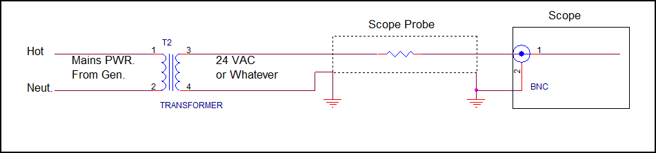

If I go with the transformer idea. I obviously connect the generator line and neutral to the primary. The output of the transformer I'm thinking of using (if I can find it) is 24VAC. I was thinking of putting a 5K resistor across the secondary to give me a 10mA/0.5W load. Where am I hooking the scope? My first intuition would be across the resistor, my second would say to connect the scope ground to outlet ground.
Nice choice in a generator. 7 KW ain't all that shabby when power is needed. Also nice to have the 240 split phase just as power company mains power is delivered. Makes for easier transfer.
You can hang a resistor out there but it isn't necessary. You would measure per the attached. I assumed a 10:1 probe since you mentioned it. Really matters not. Set the scope for AC coupling using an appropriate vertical input range. The sine wave should be 16.666 mS. for 60 Hz.

I am not really following your drawing, but it looks like you saying just to grab the two transformer leads with the probe tip and ground. Or if using the resistor, just hook across the resistor.
That's it! :)

Thank you all for helping me not blow up my new generator, may father's old scope, or me. It appears that there's a higher frequency signal riding on top of the 60 Hz signal. I had to be outside to run the generator and by the time I got home it was dark. The camera wanted to use the flash even when I said no. I had to hold my finger to prevent the flash from washing out the trace. It is very close to 16ms cycles both no load and with the space heater running.
The trace is 2ms/dev and 5v/div on the load side of a 12V transformer. I tried my meter on the 12V side and it would pick up the power cycle and then momentarily pick up on the rider. It was measuring 63Hz. Close enough for me.
